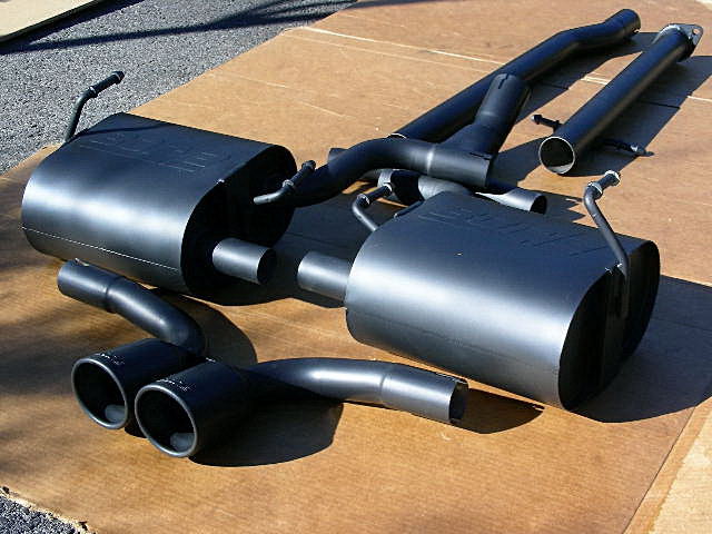

The latest item to get a ceramic coating; the pipes get hot but can still be touched, the canisters stay cool enough to hold, the tips won’t brand the shins.

wow Keith, that looks sweet, i always thought of doing this, but did not want to sound stupid and ask? Looks sweet, which is besides the point and the intention. Greg was mentioning about this yesterday, and i asked him if you were doing the CC on header or the whole system? Obviously it is the heat management, however could you possibly explain in details please?

Keith, I've been pondering the same! Did you have the coating done on the inside as well, minus the mufflers?
Adding weight? What drugs are you on!!! Where's the TonyB I know and what did you do with him?!?!? Next thing you know, you'll get those new M7 Strut Tower Braces, drive with a full tank of gas, 2 1/4r pounders in your tummy, and go over 2500 lbs!

It's me buddy! I do indeed have a penchant for weight loss... but I've actually done some mods that have added poundage:
driving lights
interior light
gauges (4)
toggles
shift **** (heavy Whalen)
Euro parcel shelf (heavier than knee bolster?)
aux input
dual cig lighter
oddment tray
and a few decals
Some coating to aid in hp, I'm all for!
