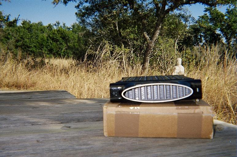

The black heat dispersant coating is not a blocker like ceramics. It will allow the heat to exit faster than bare metal.http://www.cradin.com/thermal_dispersant.htm

F15Eweapon, intake temperature was measured inside the intake air manifold by the T-MAP sensor. Ultimately, next to the combustion chamber, this is where the temps are most important in the intake path. What is significant about the higher temps on the intercooler surface is the heat transfer. Instead of the heat remaining inside it is drawn to the outside.
SpiderX, any time the IAT can be reduced that increases longevity by way of lowering the possibility for pre-detonation (I didn’t log that block on this comparison), and it enhances performance by allowing cooler denser air to be ingested.
This is not ground breaking stuff. This application is what the thermal dispersant was designed for. It’s being used in NASCAR, professional drag racing, snowmobile racing, aircraft, etc.
Again, the thermal dispersant coating is not a blocker like ceramics.

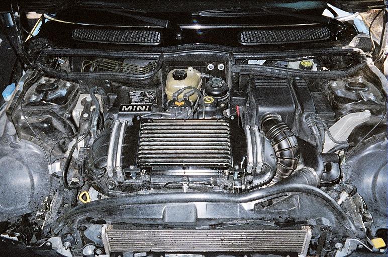

Glad to see you got it done & are happy with the results. Aside from drawing out the heat,the coating is corrosion resistant & is slipperier than the metal thus increasing the amout of air able to pass through the cooling fins.
This is a photo of mine done in grey.

It cost $50 to coat the intercooler at Cradin. It was only the second intercooler done at this shop. I was able to inspect the substrate prep testing under magnification and watch the media blasting which was worth part of the cost of admission. Be sure to remove the mounting hardware and mask the end tank lip to avoid extra prep charges. The only other place that would give me a price quote was Thin Air Power Sports in Nevada at $135. I know that PolyDyn in Houston will do it also and I’m sure Michael (namwob) will take good care your baby and by now they must have come up with a price. Oddly enough HPC doesn’t provide this service. There are many places around the country that can apply the coating so you probably can find one close to home.
