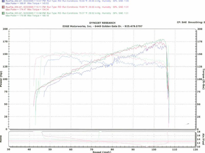

Had the Mini Dyno'd last night at Edge Motorsports. I was just curious to see what it can do. I do know that under different conditions the results would be different. This is really for myself......but wanted to post to get feedback.
05 MCS
15% pulley
JCW Intake
JCW Software
Denso's
Best run 179.88 @wheels
Torque 168.18
So its pretty close to 200hp @ Crank....exact number??
The A/F Ratio looks funny....the sensor was blown out of the exhaust during a run. I would have got higher numbers if it were cooler. But not bad

Nice runs. I'd say you are around 205-210 at the flywheel given a 15% drivetrain loss. I am not sure what the average Mini has for drivetrain loss, but it should be somewhere between 10% and 20%.

This is exactly what my 04 pulled with 15%, Alta CAI, Milltec and densos and no upgraded software. Your torque number was higher by 8, interesting.

AFR's look fine until the end, but that dip around 5500 (just a guess) is knock. The ECU heard it, and pulled some timing and added fuel. What type of fan was being used on the IC? Hood up or hood down? Was the first run the green line, and the last the blue? What i am getting at is you may have gotten more HP if the IC was being feed more air, or a larger one was in place. Still very good!
That dip happened when the sensor put into the exhaust to measure A/F was blown out. I am not sure what kind of fan but it looks the ones you usually see during dyno runs. It was done with the hood up, is that good or bad?
The green was the first run and the blue the last. It was pretty warm so who knows if the temp was lower. I was just curious I have a stock exhaust and had 168lbs of torque. Would an aftermarket exhaust actually give me less torque? Since it has less backpressure.

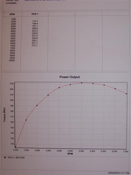

My yesterday' Dyno result
Hi Guys,
I was at the dyno workshop droping by to see my friend tuning some volvos and bmws with UNICHIP. So I thought of giving a dyno run for my car, I wasnt ready for it but I just did it. It's only 1 run to see the Hp and Torque.
My Mod:
Alta 15%Pulley
Alta Cai
Alta Stock size lighten crank pulley
One-ball
VGS
MTH
See the figure below. I need some feedback from you guys to see if this is the result expected from the current modification. Thank you!
Attached Thumbnails Dyno Results from last night-rotation-of-picture-531-medium-.jpg   Dyno Results from last night-rotation-of-picture-532-medium-.jpg
Old Jun 30, 2005 | 05:15 AM
ingsoc's Avatar
ingsoc
Joined: Jan 2005
Posts: 1,719
From: New Brunswick, NJ
That torque looks mighty high....too high?

Old Jun 30, 2005 | 12:39 PM
Rossii's Avatar
Rossii
Joined: Mar 2003
Posts: 917
From: SF Bay Area
Originally Posted by Detonics
Hi Guys,
My Mod:
Alta 15%Pulley
Alta Cai
One-ball
VGS
MTH
I agree those torque #'s are way up there. But if you feel your car to be that quick than who cares.........
Old Jun 30, 2005 | 12:49 PM
andy@ross-tech.com's Avatar
andy@ross-tech.com
Joined: Oct 2002
Posts: 3,652
From: Lansdale, PA
Any idea what the power and torque were at the wheels? That dyno claims to show "BHP" so there is some type of made-up correction factor already added to it (looks like a big one too).
Hi Guys,
My Mod:
Alta 15%Pulley
Alta Cai
One-ball
VGS
MTH
Old Jun 30, 2005 | 08:29 PM
Detonics's Avatar
Detonics
Joined: Sep 2004
Posts: 256
Im not sure abt the torque on wheels but the hp on wheel was about 182whp. So does it mean 209bhp on engine? I know there i some kind of calculation where you have to minus somw % from the BHP... but I im not too sure abt it.
Andy, does the result seems to be fine with the current mod?
It was measured in NM. The ratio of NM to actual Lb/ft is 1:0.737561 It is actually a reasonable curve.
Traditional FPS unit of power, 1 BHP = 550 feet x pounds x seconds, or = 746 Watts, or = 0.746 kilowatts
Old Jun 30, 2005 | 08:47 PM
Detonics's Avatar
Detonics
Joined: Sep 2004
Posts: 256
Yup! Please be informed that the torque is measured in NM.
1nf3rn0,
Is that the correct ratio?
Old Jun 30, 2005 | 08:59 PM
1nf3rn0's Avatar
1nf3rn0
Joined: Apr 2005
Posts: 6,731
Yes, I believe it is. Il google it to make sure...
It's tough to say without seeing a baseline or results from other stock and modded MINI's. The bogus factor that they applied complicates things, but 182 whp and 149 lb-ft sounds good.
