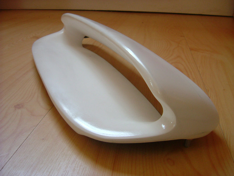

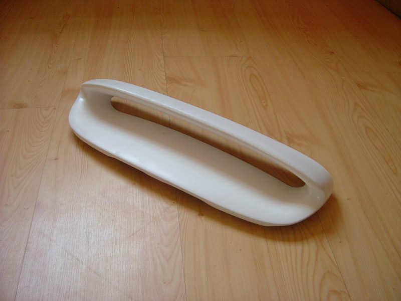

i have a couple of scoops here in the uk ready to be dispatched for painting...heres to wet a few taste buds out there....
