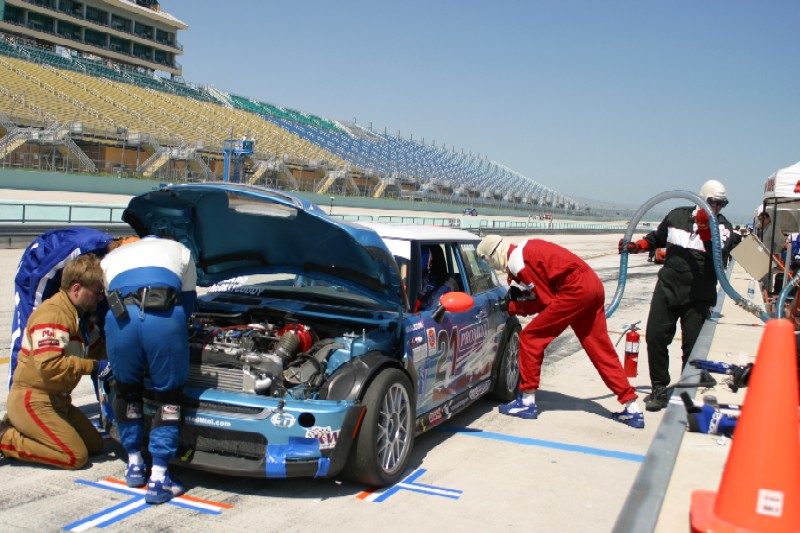

New Front Mount IC
Where can I get one of these?

Randy Webb sells one: http://www.webbmotorsports.com/performance.php

Originally Posted by BelowRadar
No. Look closer that doesnt use the factory intake horns.

Thats the BMP/Promini Cooper S/t It doesnt use the factory intercooler horns because the factory supercharger was removed and replaced with a turbo charger.

If it is turbo charged why is the air filter arrangement the same as the supercharged setup?
I believe this is the nuzzo motorsports car since that was what web site I found it on.

Yes, that is one of Nuzzo's Cars. Here are some better shots:

you can kiss your A/C goodbye and not sure if your radiator needs to be relocated from what that setup looks like.

This FMIC isn't new. ...And if it weren't NUZZO's full race set up there's no reason you'd need to lose the AC.
The unit Webb sells takes up all of the same space in the front. ...It works with the OE rad & AC. However it is a complete unit, including modified bumper.
The only obvious visible differences in the NUZZO FMIC are the elbows on the sides instead of the ram-horn configuration of the SAP/Webb unit. Unless I'm mistaken, nothing of vital significance is located in the spaces where NUZZO has the elbows.
