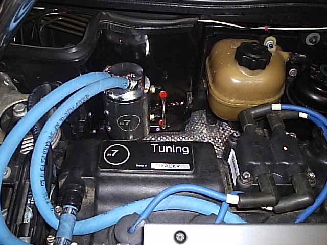

Due to extensive engine-bay modifications, Nasty Nate (lead mechanic/designer) was having trouble figuring out where to put the oil catch can. For the last couple months, I've been printing NAM postings on oil catch can mounting areas, etc. and there have been a lot of good ideas, but we had to do something different because of the factory alarm system, ProMini upper strut tower brace, etc.

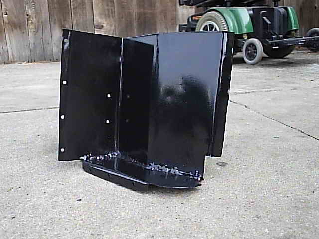

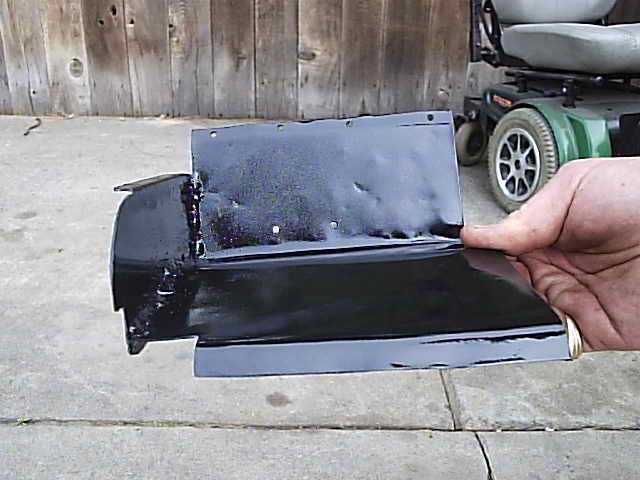

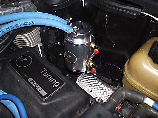

Instead of jamming the catch can in the sealed-off area underneath the passenger window, Nate had a great idea. Why not cut out part of the plastic section (in front of the ABS box) and fabricate a recessed mounting area for the catch can. Proper heat dissipation was the main concern.
Nate cut out part of the plastic section and fabricated a new recessed replacement piece out of 16-guage sheet metal. The hoses you see in the pictures are courtesy of Western Speed & Fuel. They're 3/8" hose rated for 250 PSI/17 bar. Here's the completed project. I think it's a great idea and if you have questions, I'll be more than happy to answer them.

Here are the some other pics of the project. Oh, special thanks to Peter & Randy at M7 Tuning, Eric at Helix, and Nasty Steele Performance. Cheers!

Jason, oh, I'm going AGS alright! And with that open space, I am indeed considering that location as my primary choice. The only reason that I might not put it there is that for smog checks, I'll need to reinstall the stock box, and that will require a new, temporary re-location of the occ. Ideally, I'd like to put it somewhere, and never have to move it...
But then if Peter gets CARB approval, and I think he is, then I guess that wouldn't be an issue...
