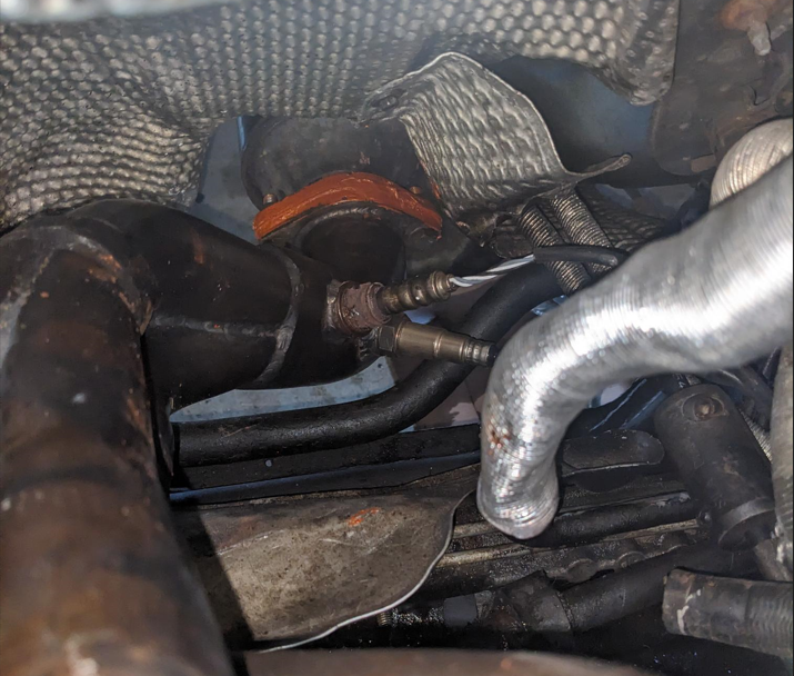

Not an RMW header but here's where I put mine - plenty of clearance and easy to get to.
