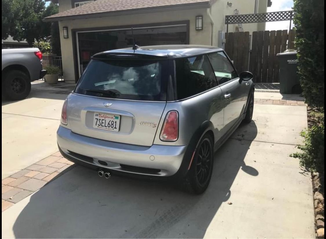

Hi NAM,
I recently acquired an 06 R53 slicktop with factory LSD and bone stock with 55k miles on the clock. Unlike my tracked 05 r53, I don’t wan’t to go all out with power mods for reliability and value retention, but spend more on brakes tires and suspension for track days. For power, I’m thinking drop in filter intake, 15 pulley, 380cc, colder plugs and adrian tune. I kinda want to Leave the two ***** in place.
Question - am I loosing much power by going with the stock exhaust and not getting an intake? At most, one ball but not sure I want to go with that unless you guys think one ball really adds/makes power.
thanks

You shouldn’t be losing too much HP with the stock exhaust and airbox. A lot of people upgrade the exhaust and cold air intake more for sound and supercharger whine than the small increase in HP. Since you already have a track car, have you thought about a 17% pulley for more lower end on this one? If you have 93 octane in your area it might be something to consider.
That’s looks like a great find... low miles, factory LSD, slicktop, good paint, clear head and tail lights, complete factory aero grille, a lot of people missed out on a good one.
The interior is really clean looking too, and it has the rare MINI Seven dash trim and door panel option. If you want to clean up the down tubes, the cup holder base is only held on with some mounting tape and the down tube screws.

A very nice looking 06 R53, MINImally factory optioned (much like my own with just chrono & LSD). Also like mine, those appear to be Team Dynamics 12-spoke wheels. As to the "quiet" aspect and as outlined in various posts in my thread topic, I replaced the cobbed-up "performance" cat-back with full Milltek resonated system (which I liked) but subsequently swapped the res-pipe for Milltek's non-res-pipe to avoid metal-on-metal rattles at certain rpms and load (which it did) but now will be reverting to the Milltek res-pipe due to (for me) excessive dbA and droning on mountain highway grades.
