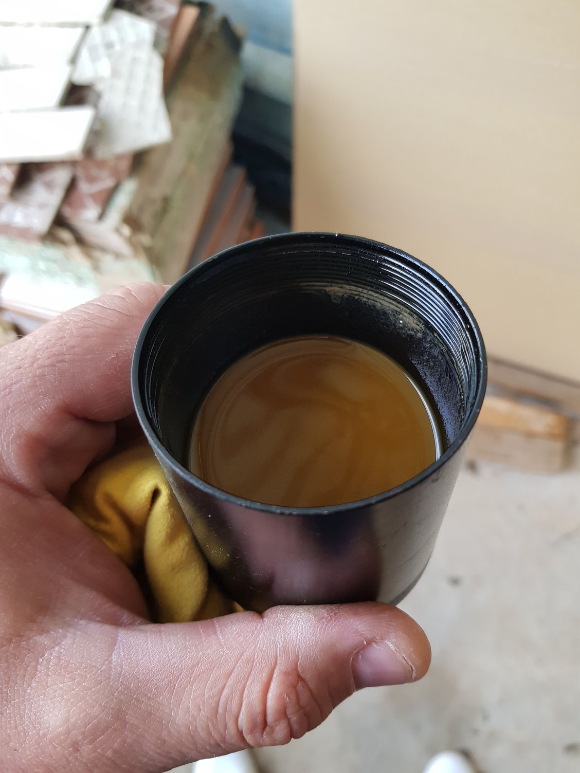

I heard once that much of what a OOC catches is just humidity from the air that wouldn't necessarily be a problem for the engine had it gone through. People install a OCC and then are shocked that it catches a lot of water and assume they have water in their oil.

You are right, im sure the external humidity has an impact on the amount of moisture in the occ. The oil it catches compared with the water is minimum. Here is a photo of the can
full occ
