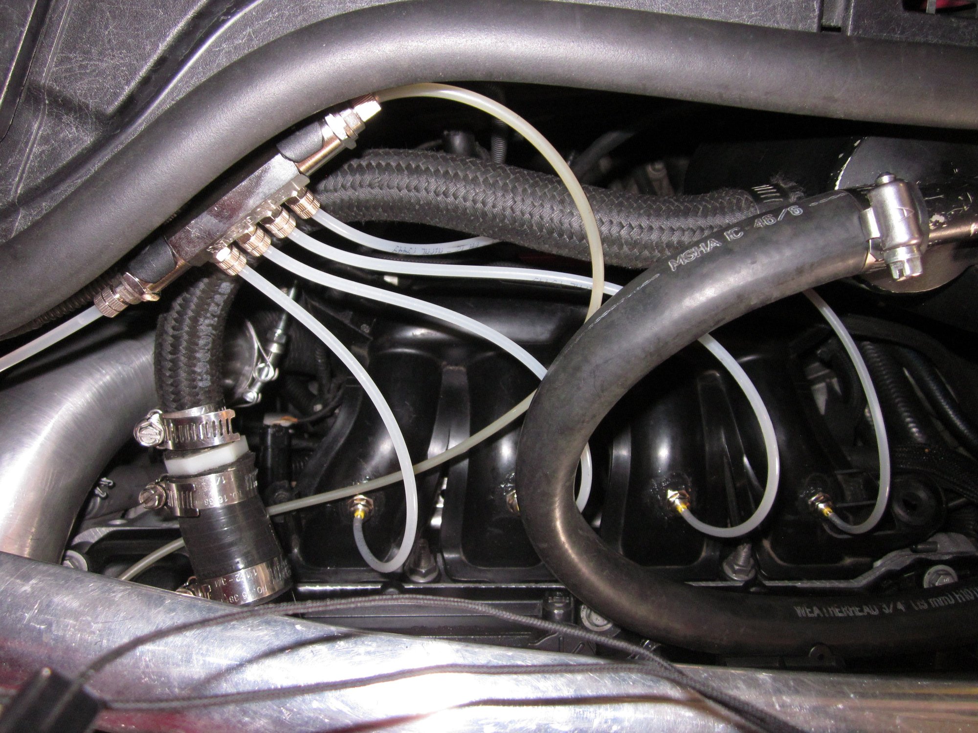

As a side note, pretty good results can be obtained by adding WMI ports to our OEM manifold. I just broke into the 400+ WHP and getting ready for 500+ with this setup ---

That's a very good MWI setup ... are you running with just the four jets, or is there fifth one going to the JMTC pipe as well?
I'm thinking about putting one in Buzz, and curious about your setup in particular.
I also previously had the TurboSmart DP and a manual boost cut, but took them off once the S42 went on. Tell me more about that part of your setup as well.

The WMI manifold hoses are, from L to R --- inlet, ports 1 - 4, ICI pipe. All 5 jets are 0.4mm.
Here's a link to the middle of my latest build thread --- https://www.northamericanmotoring.co...ml#post4519465
