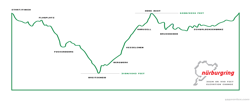

Schrick has a trick test rig that is set up as a simulation of the Nordschleife at Nurburgring...
...crazy angles which are quite similar to mountain backroads that we all love.

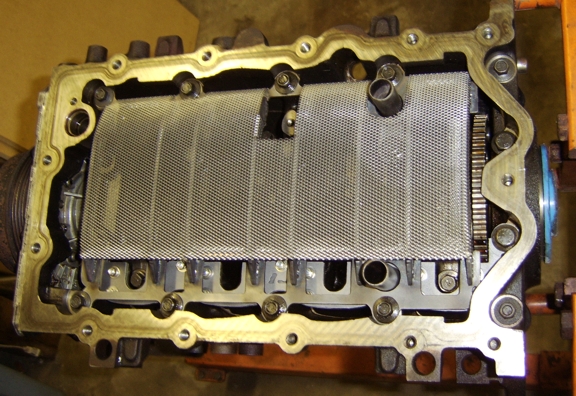

Ishihara-Johnson offers a windage tray of the mesh type + crank scrapers.
https://www.crank-scrapers.com/bmw_mini-cooper.html
And to the debate about windage trays, we can add screen mesh vs. solid louvered!
