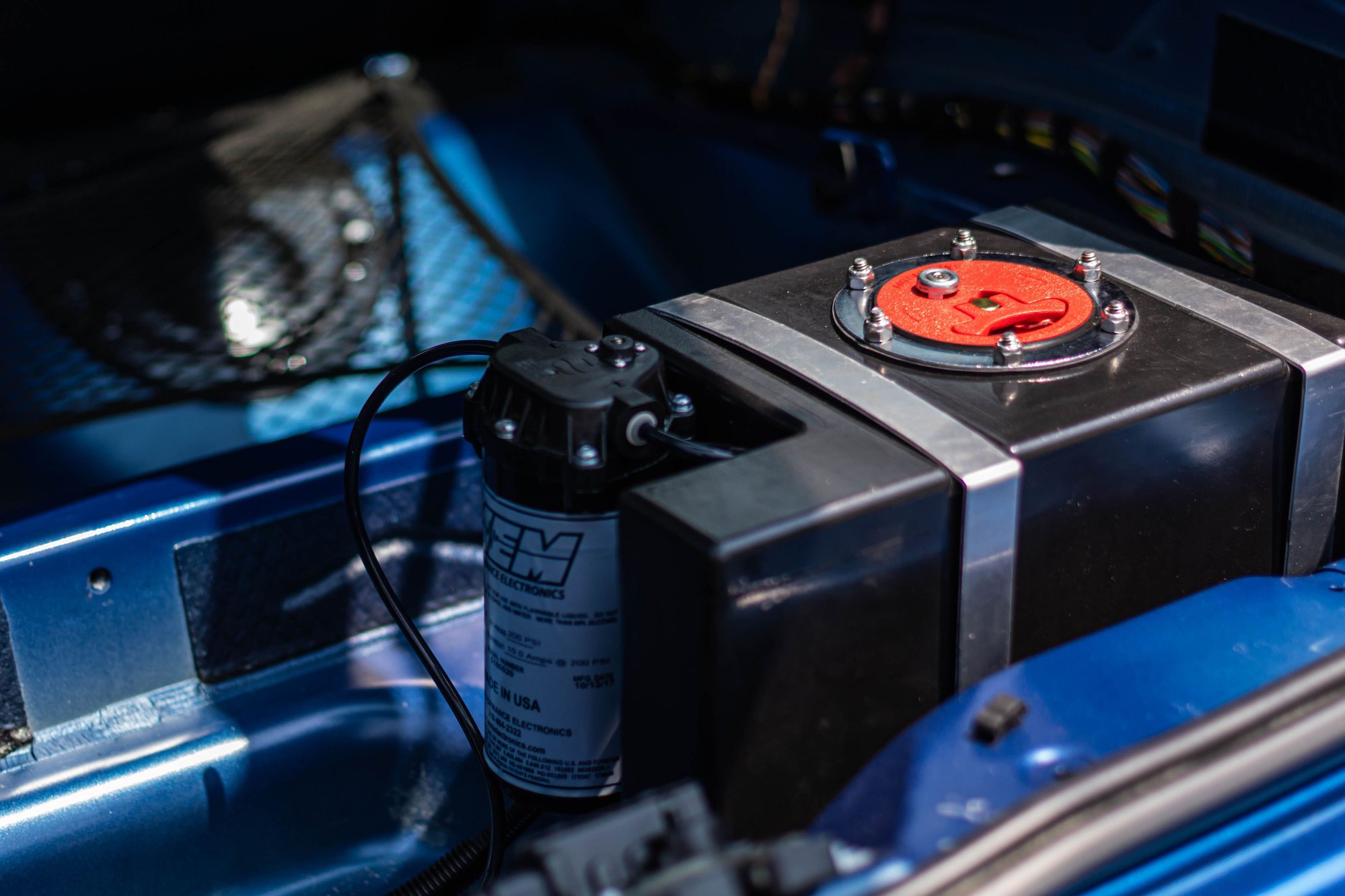

This is Howerton's tank, trunk mounted --- too bad you can't get one.

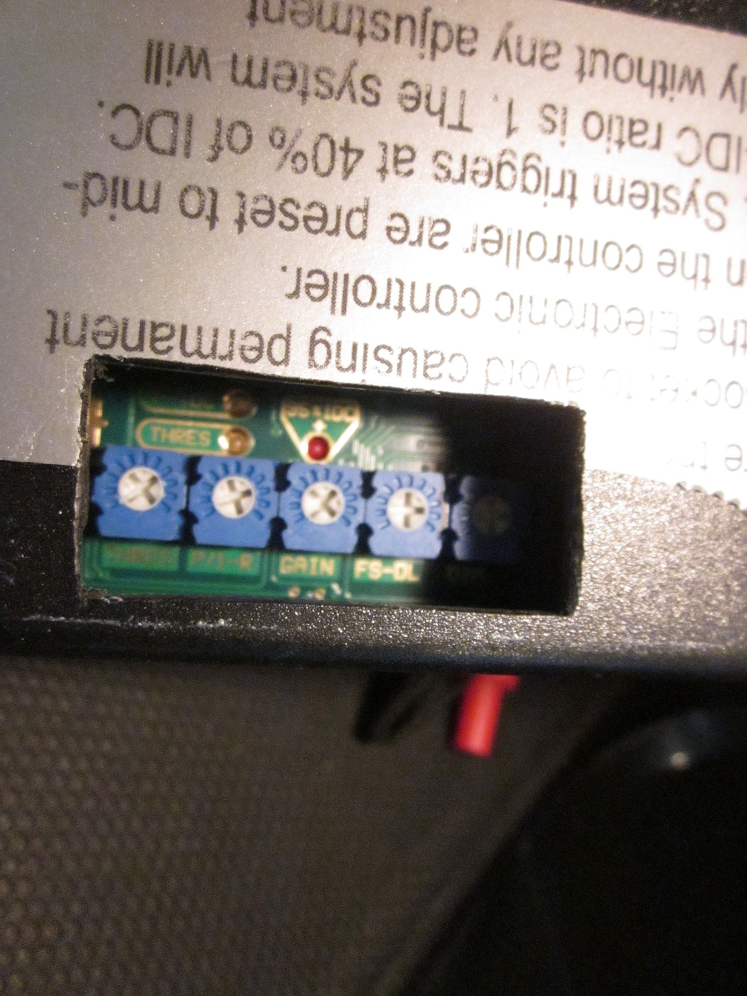

Controller mounted in the glove box, with a couple other gadgets. There's an access hole for wiring behind the battery
For ease in adjusting the controller, I cut up the housing to allow access. A piece of tape covers the hole when it's all adjusted.
For installation, a nice set of instructions was included. Wire routing is pretty much up to the installer. You'll probably need to drill a hole or two (trunk-mounted tank and glove box-mounted controller), but they shouldn't be noticeable, if you're careful. Trunk mounted parts wiring and hose can be zip-tied alongside brake lines and other chassis mounted items. Wires and hoses should be enclosed in their recommended harness wrapper --- not included in the kit, but well worth the minor investment.
