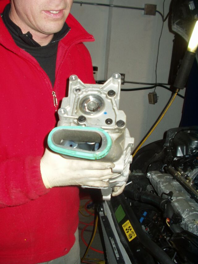

I think the layout is a little different from off-the-shelf M45 or MP45:
