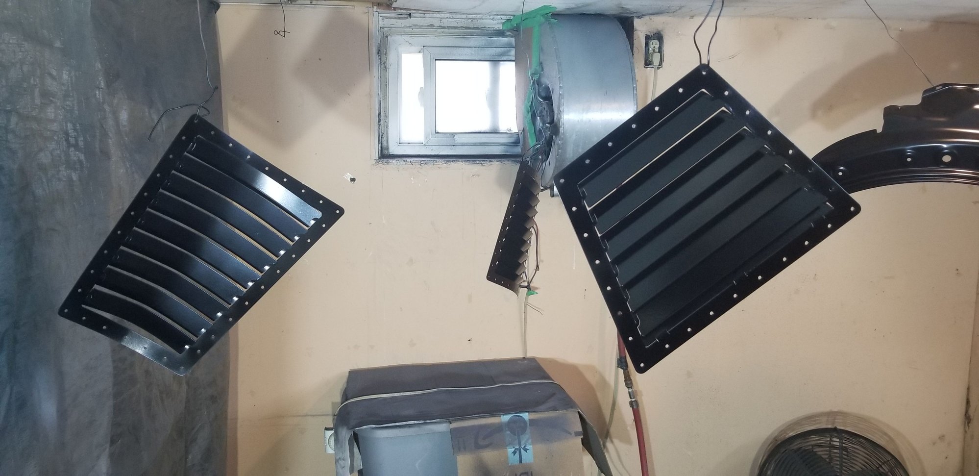

I'm currently in the design and test fitting prototype phase with the R5X hood. If you look at my thread "good God I bought another clubman" you can follow its development. It's going to have three vents, a center and two over the wheel wells. This will greatly reduce under hood pressure (lift) and give exceptional cooling. Combined with an open hood scoop it will work even better.
send me a picture of the underside of your hood. The design I'm doing will require NO CUTTING of any structural hood members. There will be some trimming of excess flanges but the hood structure will stay intacked. This is the only way to do this, do not cut structures or you will compromise collision safety.

Likes: 57
The center vent is close to final configuration. The side vent has had a major change from what I've posted. It is slightly smaller in width and tapered to follow the hood lines. It's also getting straight vents instead of curved ones. The placement of the vents also avoids any sensitive areas under the hood that could be hurt by water.

Just did the base coat on the vents. I'm going with mini Jet Black.
not so much metal working as CAD. I did the design and had them lazer cut at a shop. Took about ten tries to get it right LOL
