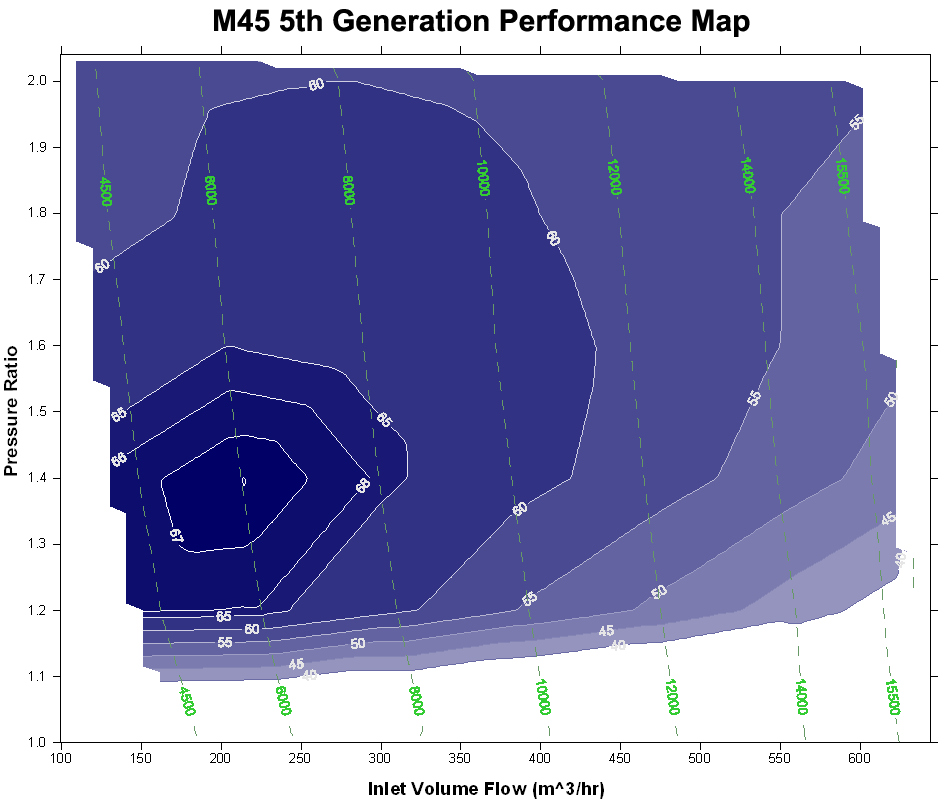

it depends on how much time you spend over 6000 rpm, the 17% goes well over the rating, the 19% quite a bit more on top of that
stock supercharger rpm at 6950 engine rpm, off the oem pressure/efficiency map
15% 16,844
17% 17,249
19% 17,675
i have a 17% on mine and I do this to it, I try to stay between 5000 and 7000 rpm lol
