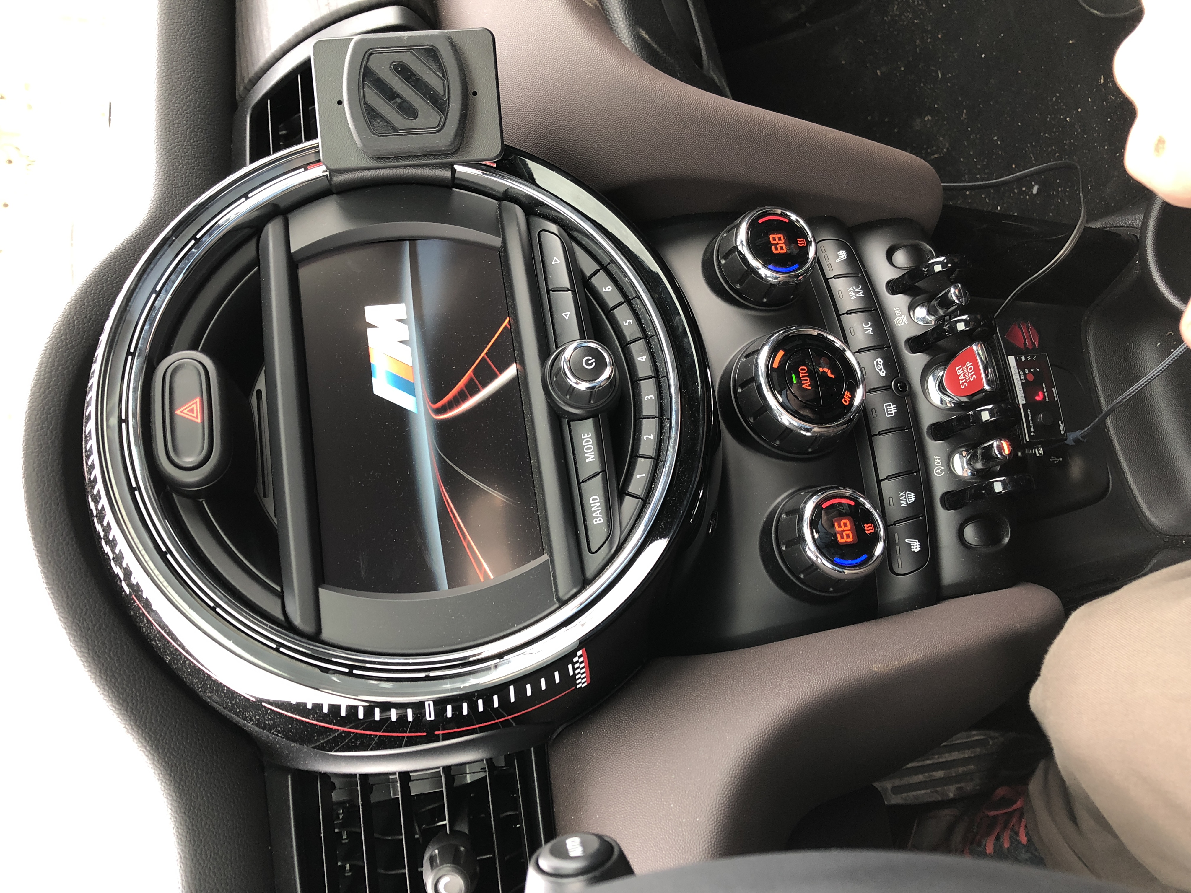

Spoke with a guy at DINAN. Seemed like a good dude. I'm bringing the car into the DINAN authorized dealer next week to see what's what. Either Mini will cover the issue or DINAN will. Or maybe I screwed up a plug and I will.
We'll see what's what.
I hope they don't care about this kind of thing ...

Now why in the F is that sideways. It's not on my phone or computer. Don't know don't care, I'll worry about it after my car is fixed.
Maybe you did screw up a plug ........
I kid, I kid
