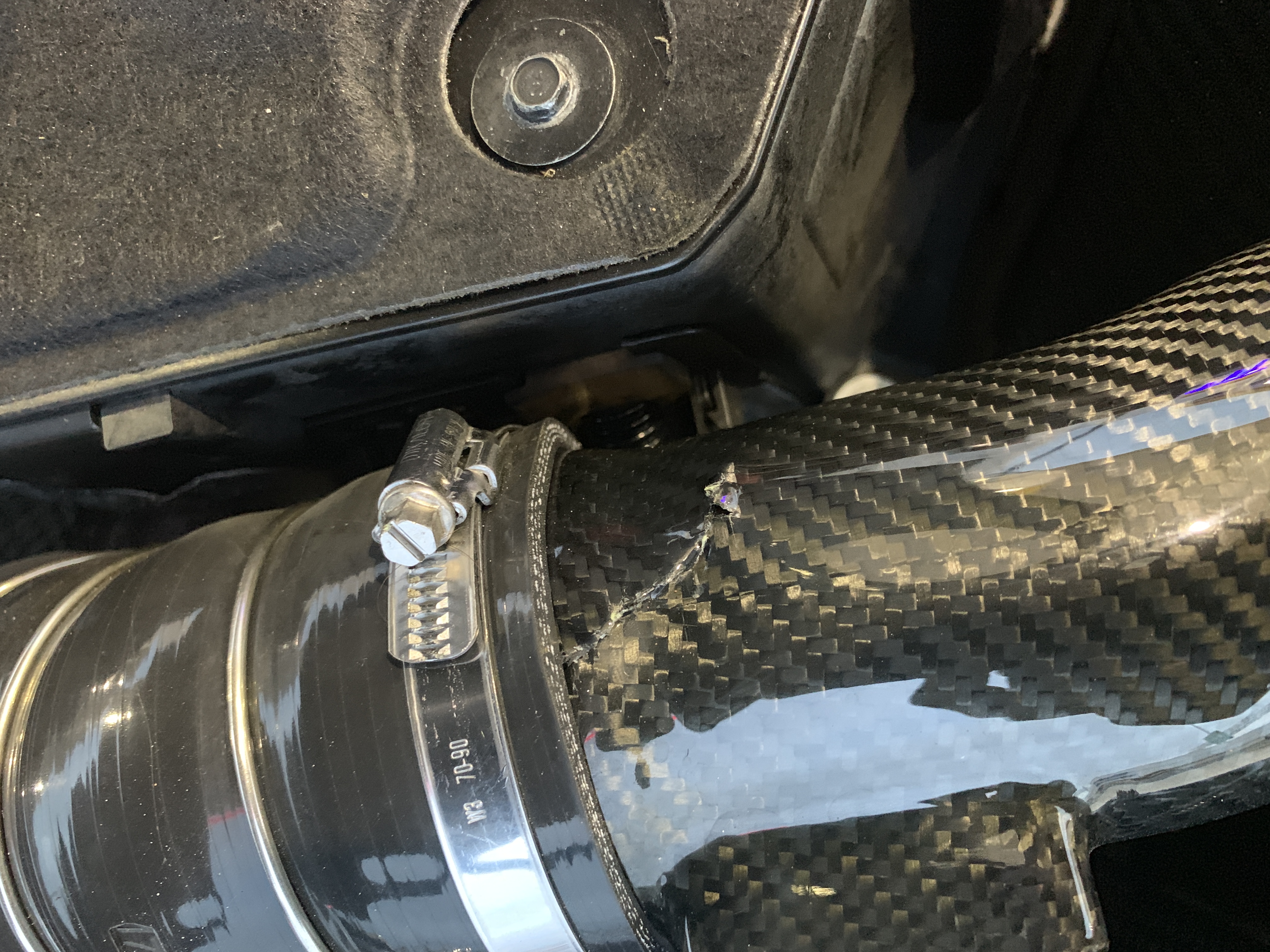

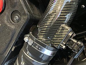

Angry Update since my Oct/2018 Install
UPDATE::: I installed the intake in October 2018. It cracked on my 1st road trip. (See pictures below). I made sure "NOT" to over tighten the clamp when I installed it so this wouldn't happen. I reached out to AWE and they said the "rubber" hose cracked it or I over tightened it. This is not the customer service I was hoping for.
Be Advised: If you do purchase this product it's no returns or exchanges even if it is defective. :(
I'll be purchasing the Eventuri intake system next.

Hi, BM.
To be clear, I nor my team have seen such an issue with this product. Of note, after showing my colleagues (of whom you spoke) the image of your engine bay from before - they were not aware your intake was mated to an aftermarket hard pipe as you only included the close up shots of the crack showing a hose in your correspondence with them.
Since evaluating all of the images, it is safe to say it is due to the hard pipe connection itself rather than clamp tightness. This is due to the lack of flexibility in the hardpipe and externally reinforced silicone coupler. As you may know the factory intake tube has an accordion section that is quite "floppy" and very forgiving to engine movement.
I apologize this has occurred, and I am aware my colleague's offered to help out with the situation.
I would suggest considering a different coupler solution if the hardpipe is going to remain in place, regardless of your carbon fiber airbox configuration.

Originally Posted by Josh/AWE
Hi, BM.
I wasn’t aware the Hard Pipe was an issue, hence I didn’t include it in the picture. I wanted to ensure good picture quality therefore I took a close up picture. There was no attempt to deceive anyone with my pictures. The help I was offered was to purchase another part. I simply didn’t feel AWE took any ownership of my issue since the reponse I received was, it “may be” this or it possibly could be that. I don’t recall any specific instructions informing me that a Hard Pipe would damage the intake. I could be wrong be I read the instructions carefully. I’m not attempting to bad mouth AWE, simply make people aware.
