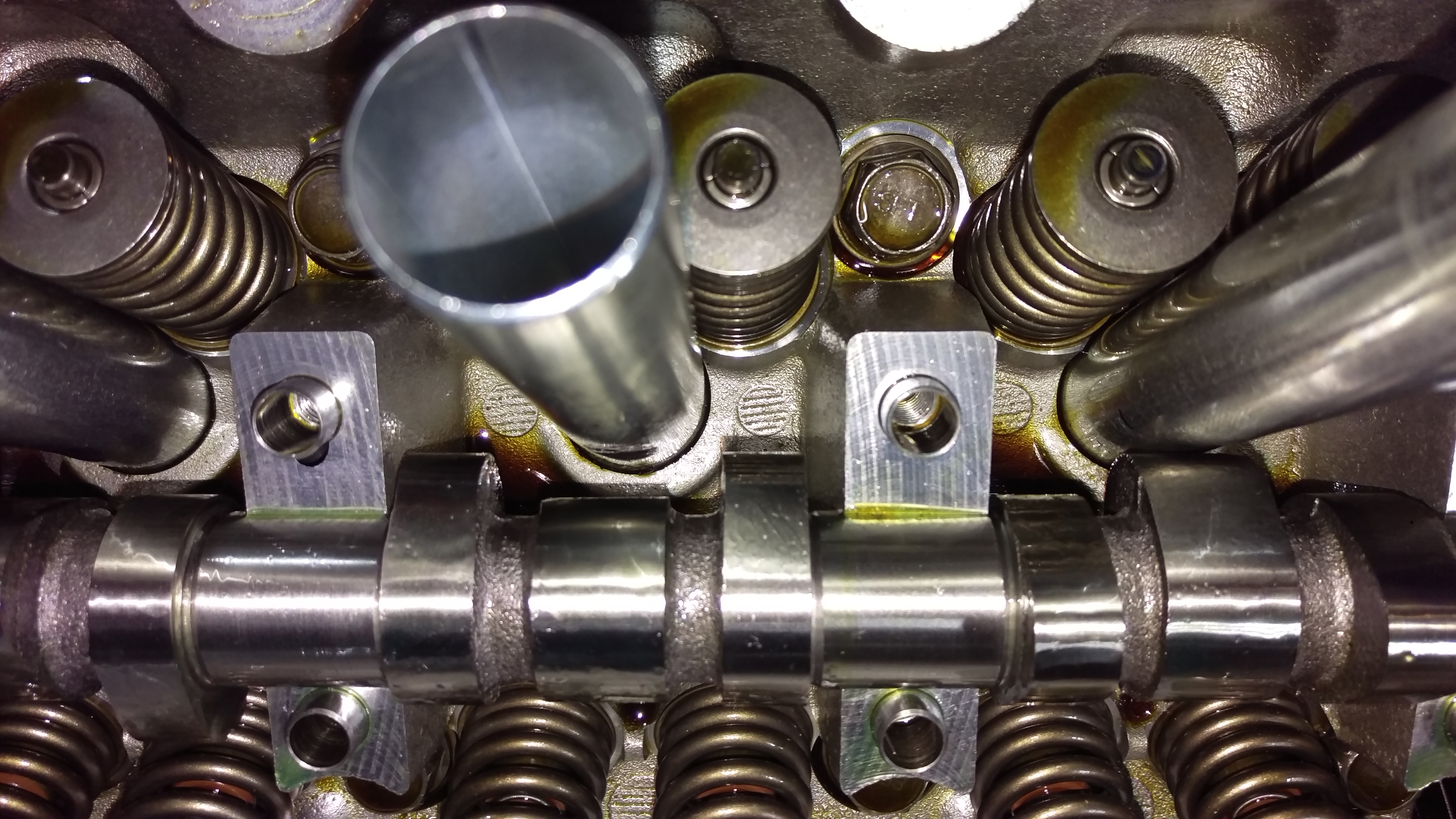

Picked up this RMW dominator cam, got it installed over the weekend. Took it out to test drive it and break the cam in for a day before a tune. Take the valve cover off and look at how close the rollers are from the edge of the cam....and piece of the cam chipped off...very disappointed in something I paid 500$ for from WMW.
Those chips were not there when cam was installed
Number 1 cylinder wore through the spark plug tube, and rollers are almost at the very edge of the lobe..
Assembled with Lucas assembly lube and broken in at 2k for 20 mins then light duty driving for 2 hours...this doesn't make sense

The OP's photo on the worn thru spark plug tube piqued my interest. So too is where you can see the rough casting as well as how close the rollers running close to the edge on some cam lobes.

The spark plug tube problem is a known issue with some Cams, and you should have been forewarned if this is one of them. (Which it obviously is)
As far as the other issues, Newman did have a bad batch or two a while ago, I thought they had all been gone through already.

did you realize the "lobe" of rmw cam is "longer" than stock right? so its normal to hit the tubes. Same as others cams.....sometime you have to ding the tube. Did you get Jan tune your car? i have had no issues so far.

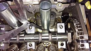

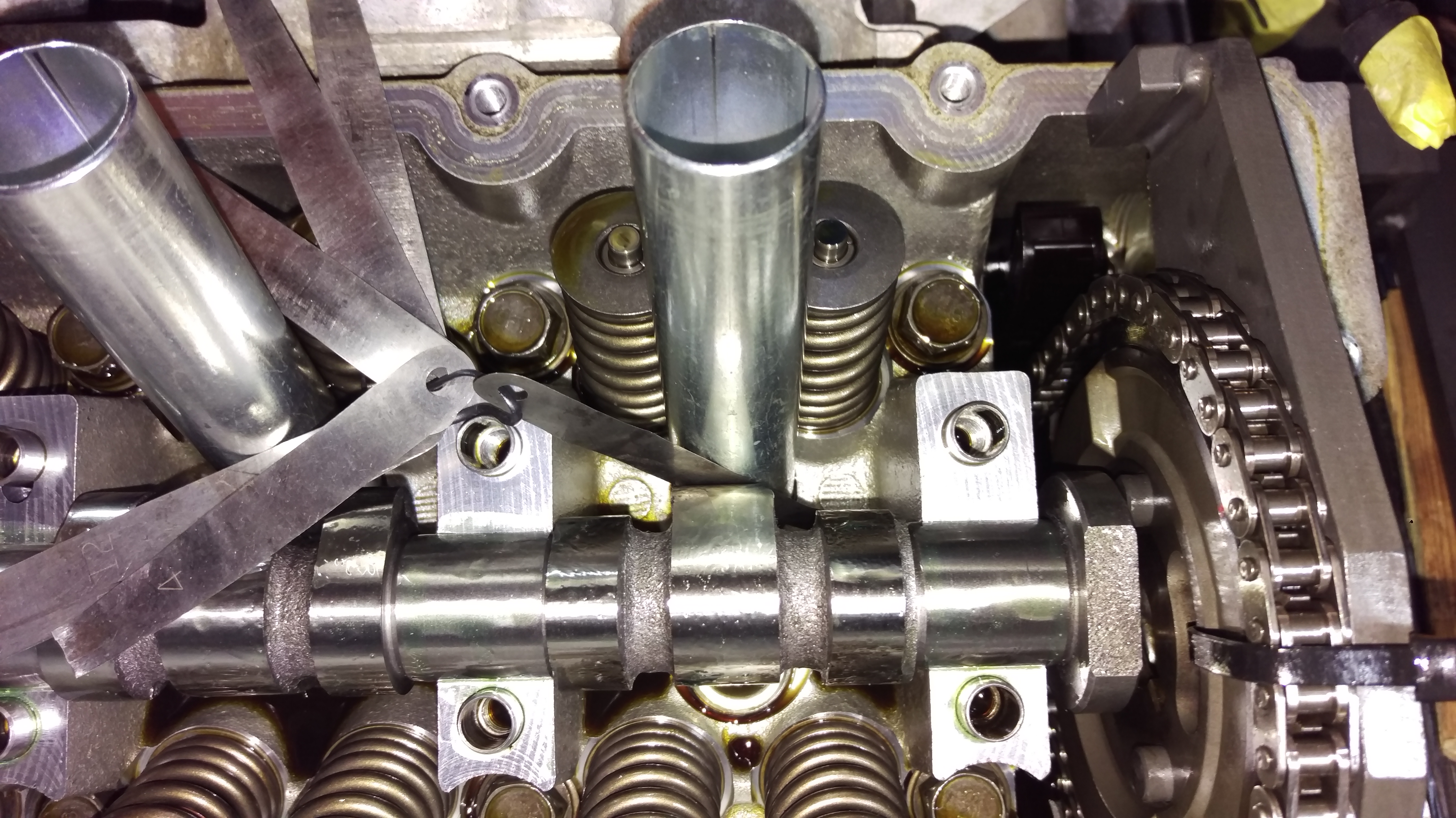

I installed this cam, as purchased directly from Jan, and it did require tube denting. Since I had heard of this issue (re. installing any high lift cams in an R53), I checked clearances during install. 2nd pic is 'dented'. Honestly don't recall if Jan even mentioned this, but I do agree it should be made clear. OTOH I suppose it could be said that if the installer doesn't hand rotate the cam and verify all clearances are good then shame on the installer.
We just installed a RMW Road Supercharged cam and had .004 clearance to the spark plug tubes. Did not dent them as 246 cam supposedly doesn’t need denting.
Just curious what the minimum clearance should be?

I don't know this for certain, but there really should be little or no expansion in that area, wasn't no movement at all.
I would guess .002 would be fine
