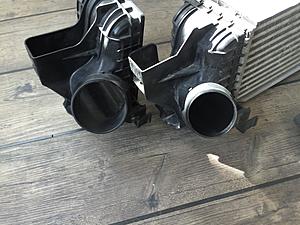

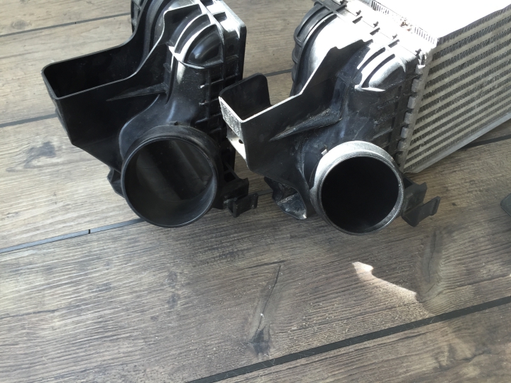

Originally Posted by Clutch Wotan
If you say the don't have a JCW Version, does that mean that they all base their In/outlets to match the Cooper S charge hoses ?
by looking at the pictures, it seems they match the OEM charge hoses but go larger...
Attached Thumbnails Intercooler Opinions/Options?-screen-shot-2017-08-23-at-4.16.57-pm.png
For performance imho the size of the diameter is not unimportant.
https://www.northamericanmotoring.co...1&d=1503576570
The use of an intercooler for B38/48 can be considered for non JCW versions, even if not necessary. Anyhow for the Cooper S the Airtec is certainly worth a look !
I also prefer to use the HEN System so the OE charge hoses make sense. They don't offer a JCW, what underlines above.
Attached Thumbnails Intercooler Opinions/Options?-img_2211.jpg
