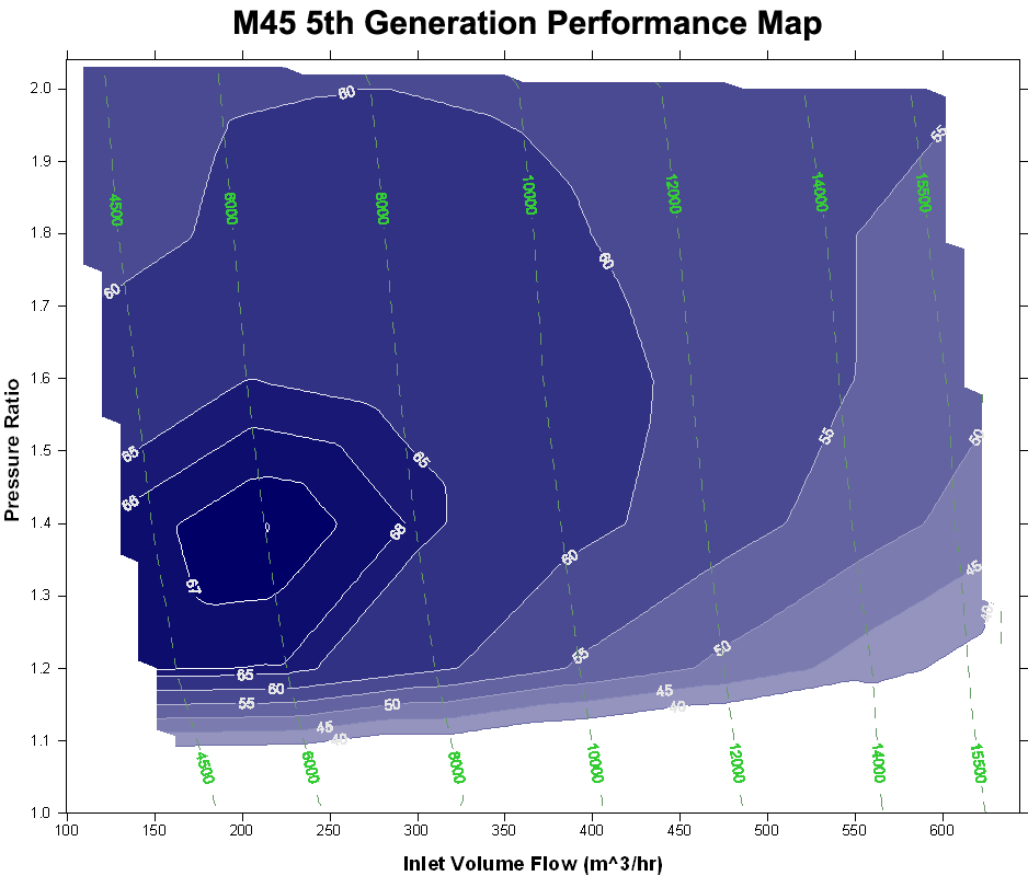

It's working fine so far. Installed with the 70mm pulley which is giving about the same HP as the M45 with a 15% reduction pulley. The 65mm pulley is going on after the CotA race weekend May 3,4,5.
The IATs are much better and heat soak appears to be almost a non-issue now. The M45 was being run literally off the Performance Map. The TVS 900 isn't even being pushed yet.
TVS 900 Performance Map
Drivability is a tuning issue. This is in a race car.
Got the kit from RMW.
