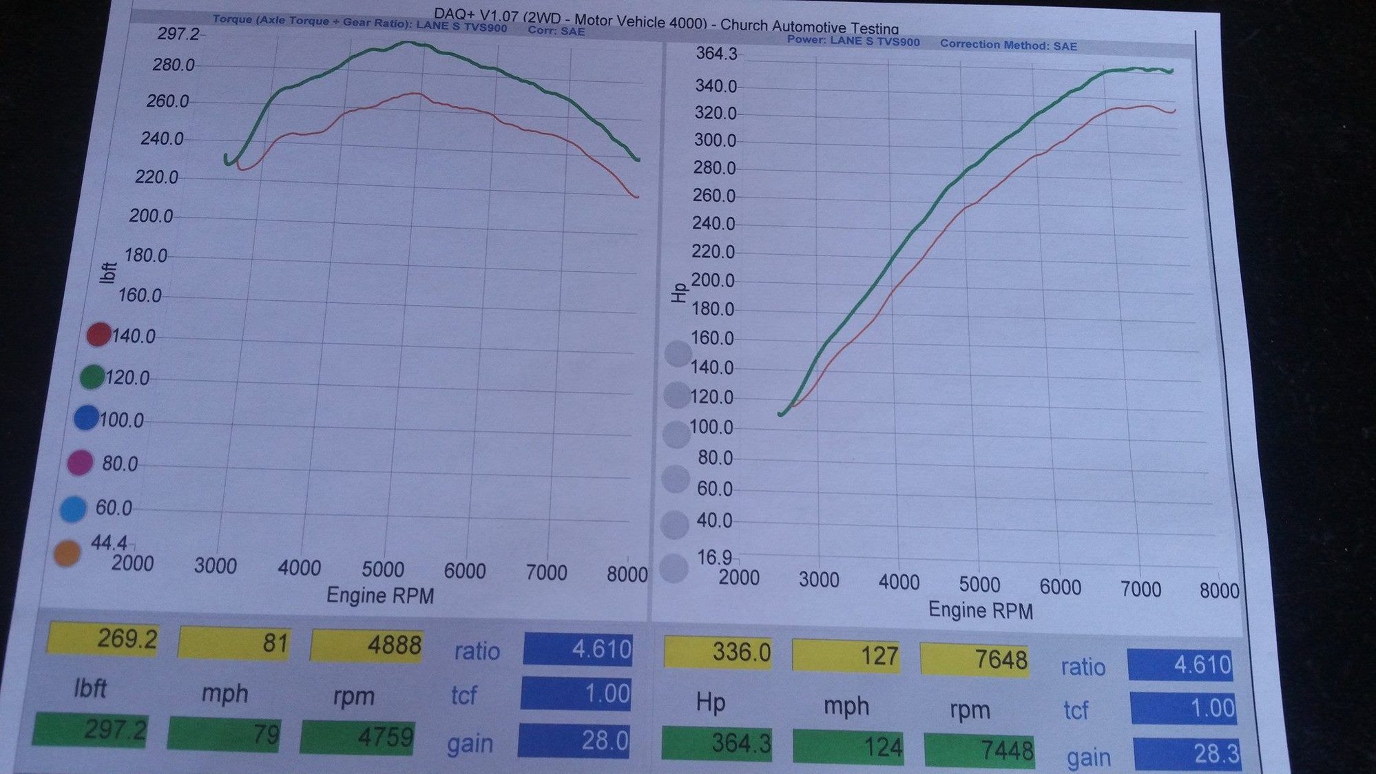

RMW TVS900 FMIC kit with E85 upgrade on a RMW 1.8L stroker

IMO, while the TVS can make more power overall, the Sprintex is more DIY friendly and the second gen units are much more reliable than the older ones.
plus the Sprintex kits are pretty complete and less expensive overall.
Remember, the above graph is also on a stroker motor with e85 on Church's DynoPack dyno. Take away the e85 tune and extra displacement and you'll lose plenty of that HP. That post is to show what's "possible", not what is normal.
Overall it will still be more than the Sprintex, but at a cost as well.
Honestly, be happy with your Sprintex, if you want more, you have that option with just simple pulley changes and a retune. The Sprintex with the 60mm pulley and some W/M or e85, is honestly very fun and enough for most anyone, and it will put to shame most other cars in the Mini's class. (It will blow the tires off almost anywhere in 1st gear)
