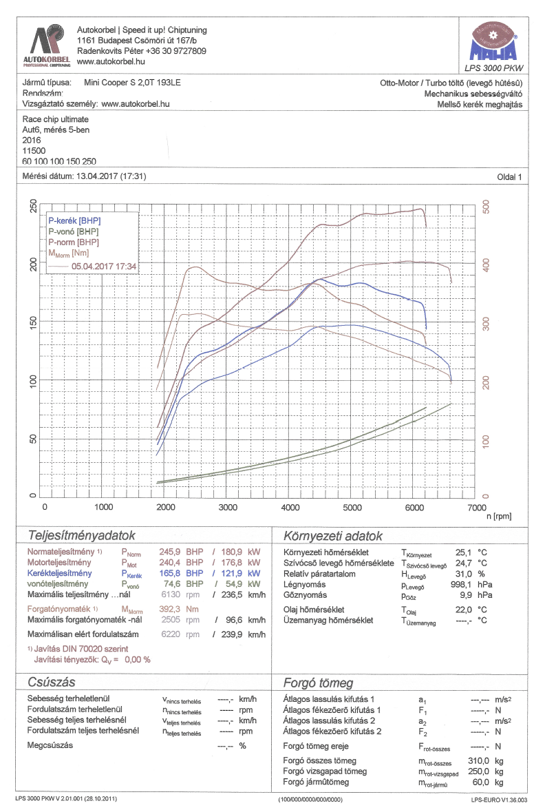

Well guys, what should I say .. I'm 100% satisfied ..
Bone stock:
201,4 BHP
312,5 NM
RaceChip Ultimate - Setting 2/1 (Original was F/1, I did switch it immediately to 2/1 did not drive one meter with stock tuning of the box. 2/1 is the maximum advised setting in the manual and the support told me the same, that I should be safe on 2/1 for daily use)
245,9 BHP
392,3 NM
Dyno image attached .. :D
Attached Thumbnails RaceChip Ultimate - Dyno and real life numbers-f56coopers_racechipultimate_21.png

Nice results! A bump of 44.5 BHP / 79.8 NM (58.9 lb-ft for those of us on this side of the pond) should certainly give you a bigger grin when you slap the loud pedal. Thanx for posting up your plots.

It feels like a completely different car, however if you look at the dyno graph, the curve could be better. As soon as the 2 year warranty is over, I'll do a proper remap!!
