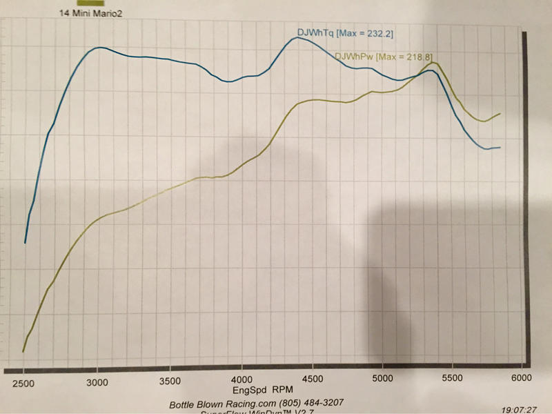

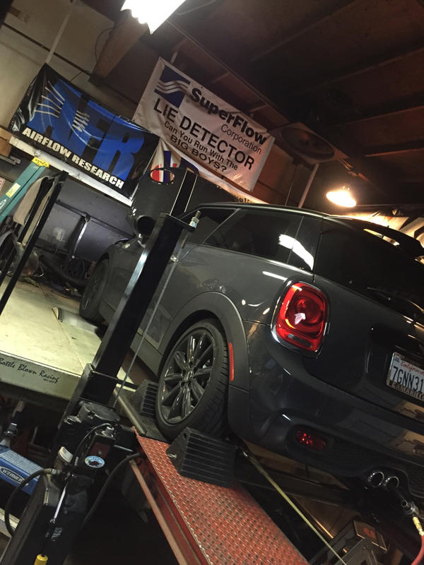

Today, I finally got car to go into "roller test", I had the sequence correct, but not the timing. I was hitting the Tach button to quick, before it had a chance to cycle through its normal start up. For a stock B48 it did really well with only a BugerTunning stage 1 JB. I will be back to the same dyno at the same 7pm in the evening, but with my 3" downpipe. This is one of two, but the first to have before and after numbers on the same car, same dyno same temps. The car dies off around 5400rpm, but with production of my Ceramic DP, larger IC and companies like Burger and NM, getting more out of that little turbo is right around the corner!!! dde01

Nice to see some jcw beating numbers

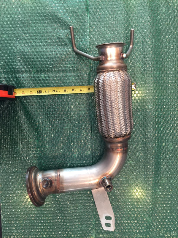

have you ran it with the downpipe yet?

Yes, but not on the dyno yet

how do you figure that? His numbers are very nice but the F56 JCW is rated 228hp and 230+ tq. (TBH I was disappointed with the new JCW torque numbers - I was hoping for 260+lbs tq)

You're comparing wheel HP to crank HP, so there is a chance that these are JCW beating numbers

Exactly. It's ridiculously under-tuned.
Actually, (at least with 2nd gen) MINI has had a habit of producing the advertised numbers (or very close) at the wheel when put on a dyno. I have personal experience with this on multiple MINIs.

My numbers are are 218whp and 232wtq, but at the crank (12%) it's 244HP and 260wtq. I expect these numbers to be even bigger with the DP installed. Hopefully dyno tonight or Saturday.

With a simple third 3rd gear pull with a JB+ I did some strong numbers, but now adding my CNC 3 times larger intercooler, to compliment the new plug and play high flow catless downpipe.
