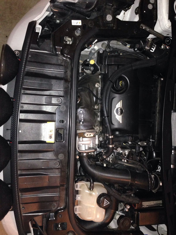

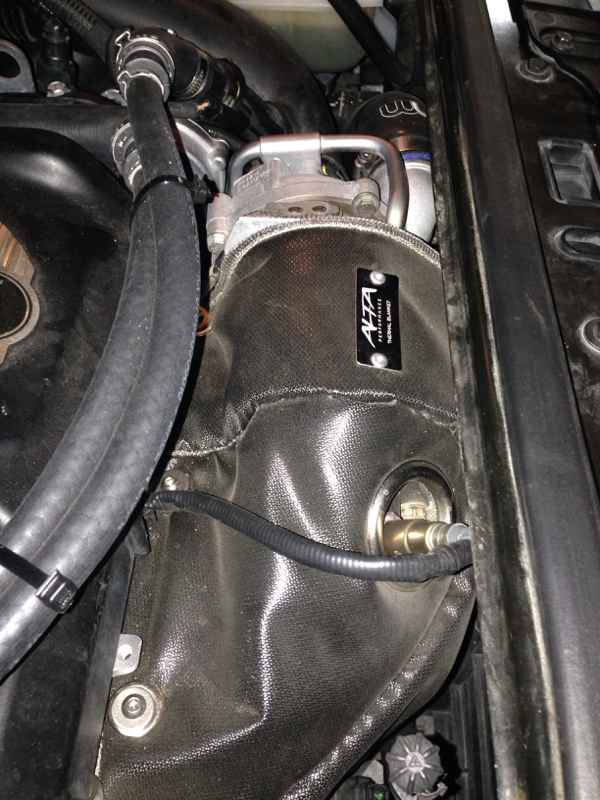

I have the Alta turbo blanket and it works very well. Not a fan of the company but do like the product. Fits well.

Yea I am not a fan of the company either, but am still considering it. Any chance you can load some pictures? I have seen a few but nothing focused on it. Thanks.

Will do tomorrow.

I had the blanket from way, within a year there was a good amount of surface rust on the turbo where the blanket was. Haven't felt the need to put it back on. That was in central Delaware and I don't remember if it was on for the summer only or if it went through a winter as well. It's worth noting that I do not have the front portion of the heat shield installed.

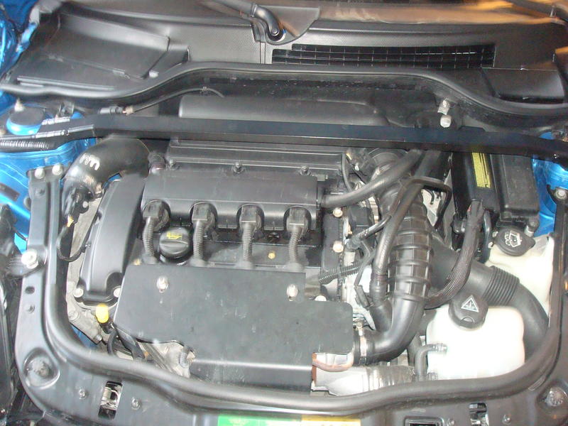

I've had an M7 heat shield mounted above the factory one. I like how it cleans up the engine compartment, I'm a fan of black.
Have fun,
Mike
Have fun,
Mike
It my be worth taking into consideration that your turbo produces a large amount of heat and that shield not only blocks some air flow, but since it completely covers the entire turbo, you have now produced a nice little heating zone for your oil feed line and the cold side of the turbo. So keep the engine bay looking clean at the expense of shortened turbo life....

The factory heat shield is still in place under the M7 piece, and there is room for circulation around the oil line. Valid point, but I have not seen any issues since running the heat shield for over 40k miles and 3 years.
I read that someone took off the factory heat shield and melted the valve cover with one of these heat shields.
