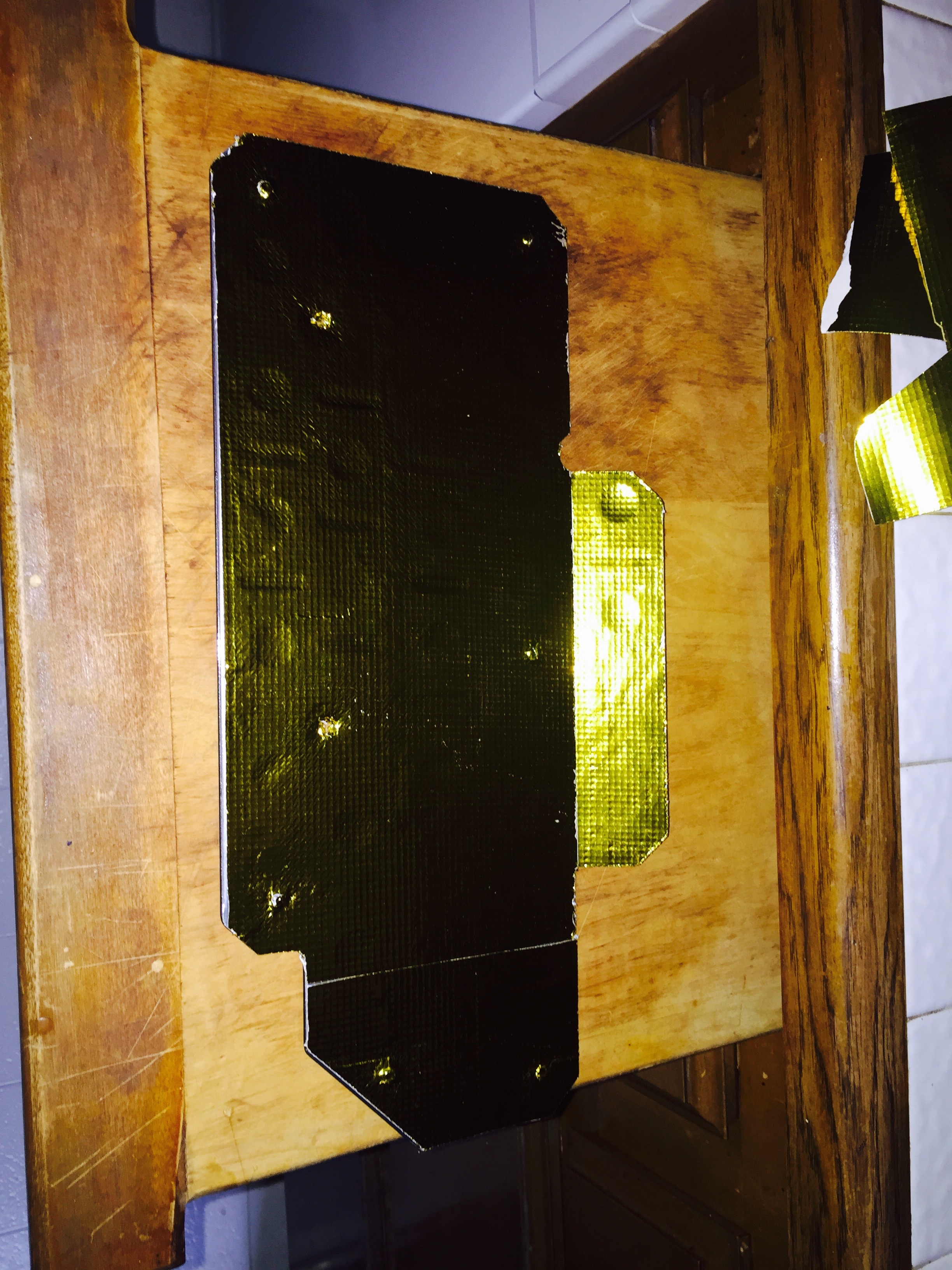

I had this insulation tape I use on my large sportbikes. Its trick stuff shame hiding it underneath, I used it on the underbelly of my AEM heat shield. Had a large scrap after doing my bike. 675 f insulation factor. Its net benefit probably limited.
