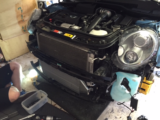

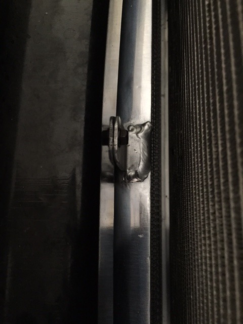

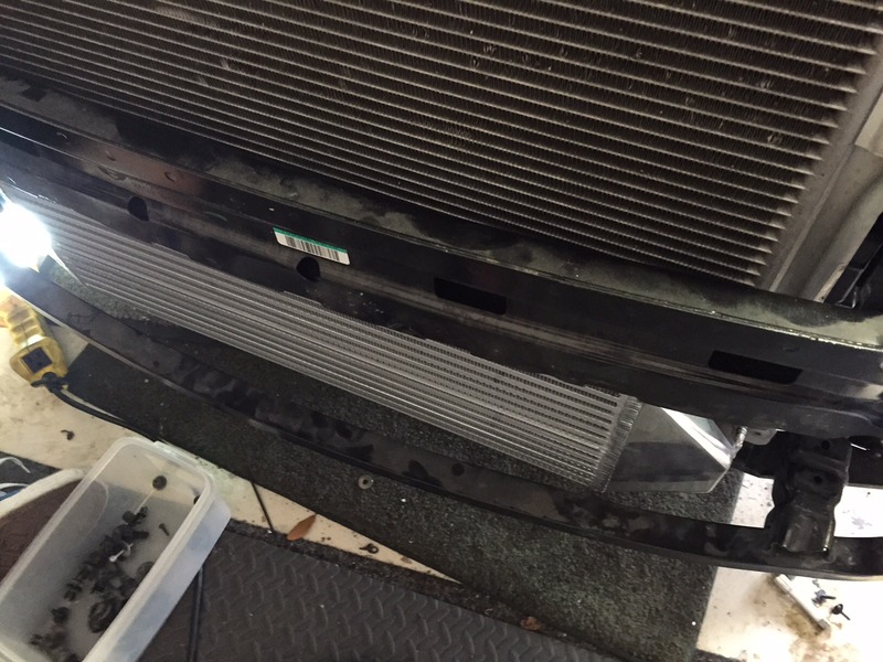

Ok got my eBay FMIC today. First, out of the box in perfect condition , no bent anything, including tabs, double boxed too. Got from same seller OP used.
Initial notes, weighs slightly more than forge , my scale said 14.5 pounds. Not enough to notice, eBay has 14 rows vs forge 11 rows, not sure on how this will effect because you have to calculate vol etc of each.
I like the clean look of cast end caps. Then I pressure tested it to 40 psi , no leaks. Will be installing this weekend. And let you know how install goes.
Friday night I'll be having to pull my splitter first.
Old May 23, 2015 | 02:53 PM
  #32
rckrzy1's Avatar
rckrzy1
Joined: Oct 2013
Posts: 1,417
Likes: 16
Ok, installed mine, fit with no issues, clears the "new" bumper bar on my 2013. I did have to remove entire steel bumper assy to install, but thats a piece of cake to remove compared to getting to that point. Tapped a 1/4 20 hole for center tab, which some say it don't work ? I dunno maybe different year. and the KICKER it WORKS GREAT, did some full long pulls to 90 mph and and ambient was 83 , max IAT was 88 , held it to 5 degrees, that is 10 times better than stock.
