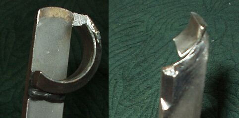

How do you not break the BMW tool?
First the weld broke. Got that welded.
Then one of the pins broke. Mine worked okay with only one pin.

It is highly recommened that if you get an oem tensioner tool, get it rewelded into THE TENSIONATOR:
... or else it will do this:
I don't know why you really need one of these unless you are changing belts/pulleys regularly? A large screwdriver or crowbar works just fine.
Andy, what did you do to that thing and what kind of metal is it?
The TENSIONATEHER?
I do both
The TENSIONATEHER?
I used it twice, the second time it had the consistency of warm taffy. It appears to be made of "steel". It is ferrous, attracts a magnet, and rusts easily, yet it appears to have the strength of pot metal.
