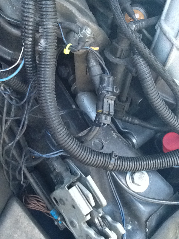

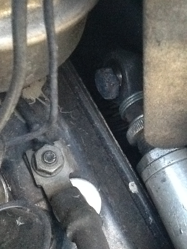

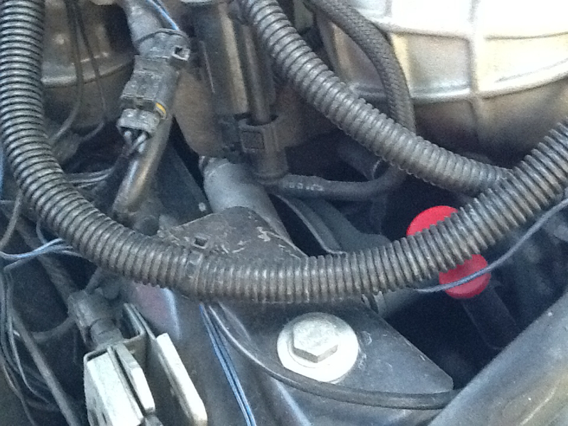

Took pics. Finally posting.

Is that thing bolted to the belt tensioner? I would prefer the tsw top mount version of that's the case. Then save up and get the Vibra-technics.

no, it bolts right to the engine block actually. its a pita to get the bolt tight, but you can do it with a large flathead screwdriver and a hammer; you hit the bottom edges of the bolt, tightens right up (also loosens too).
once you get the hang of it, you can take this thing off / on in under 5 minutes if you have to do servicing of the tensioner, or raise / lower the motor.
the key is to use the plate it comes with UNDER the frame so it spaces the damper away from the frame enough to keep it from hitting.
______ -frame
===> -plate
==( ) -damper

scary lookin haha

its just crappy ipad 2 pics.
so much easier to post via ipad than the forum, but the camera blows terribly; compromises are made in lieu of my laziness
