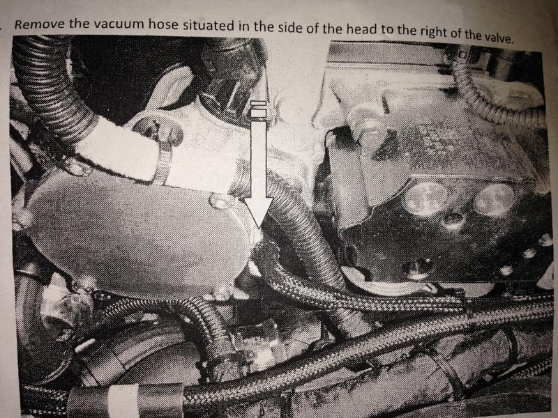

  • Also, I have read that some used the boost tap to run this system. But my instructions state to use the point where the vacuum hose is hooked up next to the stock DV, pic from instructions:
  • What's the scoop on this, am I missing something?

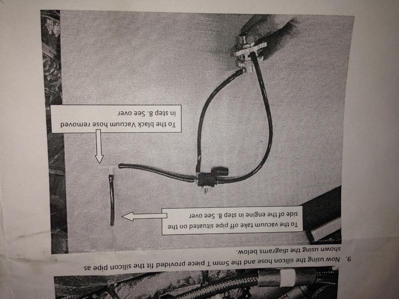

  • I stumbled upon this when I went to hook up my boost line for my Methanol controller. My mechanic actually tapped into this set up to track boost:
So I guess the whole time I was pushing methanol, my controller was triggered off vacuum rather than boost.
But now that I'm running the stock DV, I realized that I needed to utilize a true boost tap.
NM Boost tap ordered. Cant wait to see how well my W/M kit works when actually reading boost rather than vacuum

Here is another thought... Could the fact that my mechanic tapped into the vacuum lines of the Forge DV, have anything to do with the spring getting stuck? I know that the Forge DV is a mechanical valve, where the stock is controlled be the DME. I'm wondering if tapping into that flow cycle (highlighted in the second pic of my first post) had disrupted the normal operation of the DV.
Oh well, we will see how well my W/M kit operates once I install the NM Boost tap.
