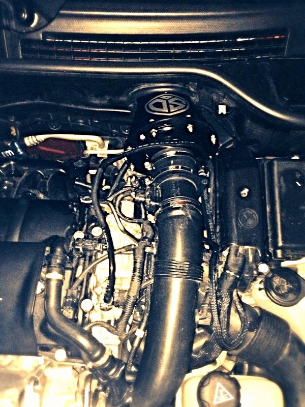

  • DOS CAI); Awesome sound, and compliments all other MODs(Install: Easy)

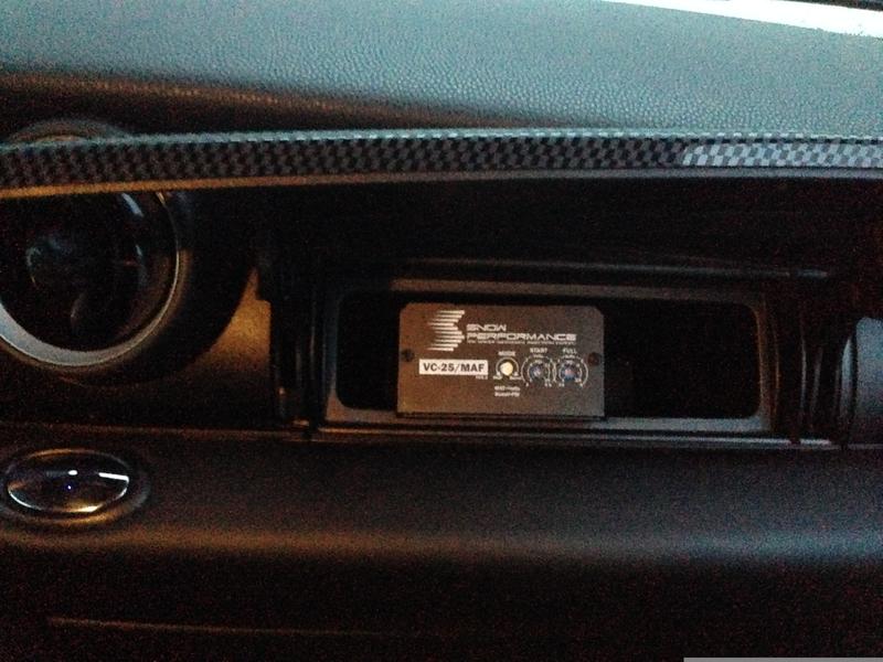

  • Snow Performance Water Meth Kit:
Controller Tucked away in the secret compartment

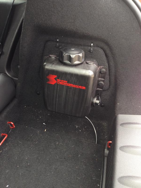

Tank in the Boot, with Pump stowed away out of sight out of mind
Attachment 96928

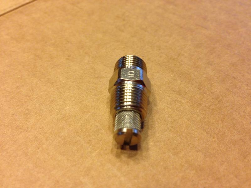

Lastly added a 315cc/min Micro Droplet Nozzle from Devils Own for a more efficient spray
Attachment 96922
Attachment 96926

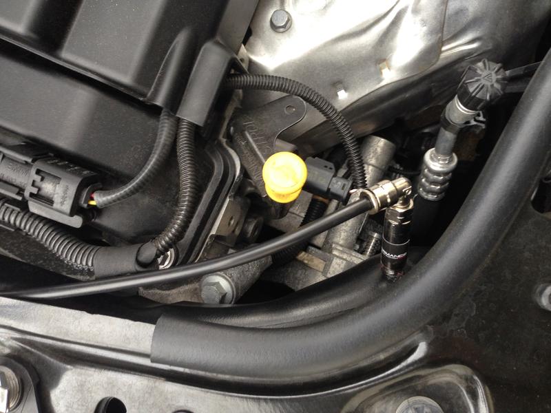

(Install: Moderate/MINI Mechanic) as long as your Mechanic dose not hook up Controller Boost Tap to your vacuum line

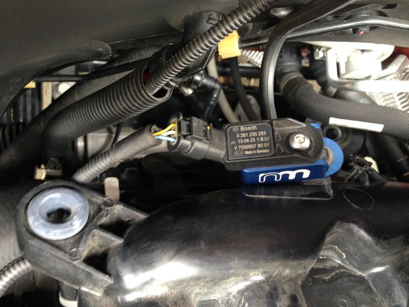

  • NM Boost Tap: (For W/M Controller) Works as prescribed...
Attachment 96920 (Install: Easy)

You are more brave than I. I had a Euro Mechanic install my W/M Kit. I went w/Snow Performance. I could not do the install due to my lack of electrical knowledge, LOL. However, the mechanic tapped the boost line to the wrong source. Ended up using my Vacuum line off the Diverter Valve I Guess that's why things are best done, by doing it yourself. Anyhow, just got my NM Boost tap in the mail, should have it all up and running by end of week. Looking forward to what my timing will look like with a proper

NM Boost Tap:
Attachment 96918
Attachment 96919
Attachment 96920
And then I was able to re-attach my Water/Meth Controller and run some Boost Juice:
Attachment 96924
Attachment 96928
Attachment 96922
Attachment 96926

It's a progressive controller. I have it set to turn on at about 7-8psi, and full spray hits at about 11-12psi...
