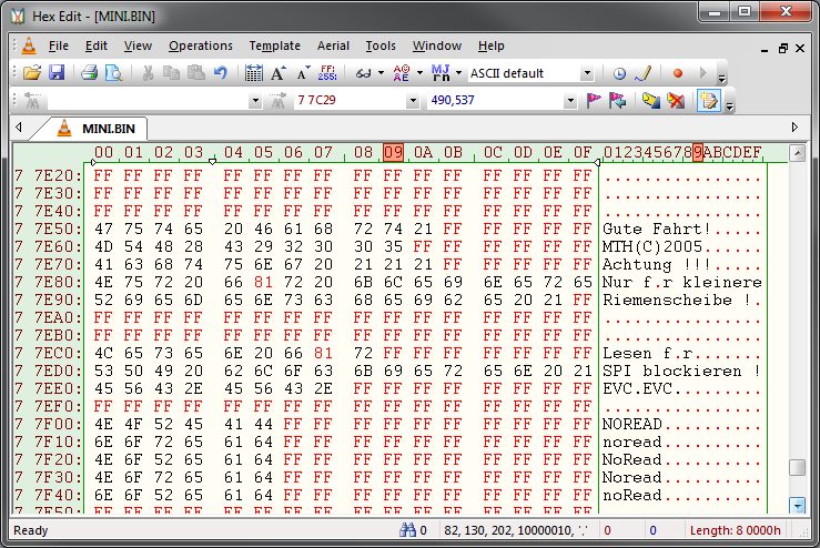

Once you have finished saving the file, you will need a HEX editor. I use HexEdit from www.hexedit.com.
Now comes the boring part--searching the file. Look through the entire HEX file to find anything that is human readable. Most tuners put some sort of signature in their tunes. This is what I found near the end of my file:
The interesting bit:
I recognized this right away as German. The loose translation is:
Now I was getting somewhere. After a little google searching, I discovered a tuner named MTH out of Germany: http://www.mth-minipower.de/
Gute Fahrt!
MTH(C)2005
Achtung !!!
Nur f r kleinere
Riemenscheib
MTH(C)2005
Achtung !!!
Nur f r kleinere
Riemenscheib
Have a good trip!
MTH(C)2005
Warning!!!
Only for smaller
pulley
MTH(C)2005
Warning!!!
Only for smaller
pulley
