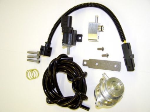

I just bought a forge system from a gentleman in the NAM classified adds. It dumps to the atmosphere, but also replaces the stock diverter valve. He has been running it for a year and a half with no CELs.
http://www.forgemotorsport.com/conte...product=FM207V

I have the adapter, NO CEL. Here's my logic.
EVEN if the air IS metered, it gets shot from the turbo compressor into the air intake (tube between turbo and air box) THROUGH the turbo.
... now... that air, where does it go? Back through the intake and OUT to atmosphere... it's just MUFFLED. It's definitely not HELD in the air box. I don't know, but I assume the car MUST start over the air metering process as soon as the recirc valve opens because it's just NOT going to be the same once the intake stops allowing the boosted air in. Just my logic.
bottom line, no CEL. And injected doesn't just spout his opinion. He explains it and the points I've talked to him about are all solid.
