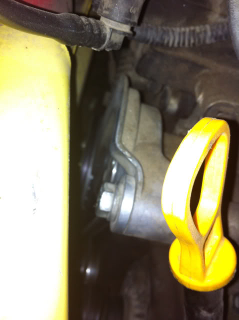

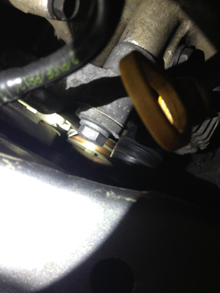

I cannot really tell so hopefully you know what to look for, Sorry in advance for cell phone pics :O

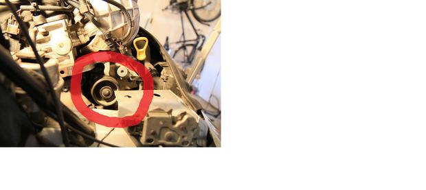

It looks like it has 4 bolts holding it on so I think it is safe to assume you already have a smaller pulley. The pic here shows the stock black pulley with no bolts holding it on.

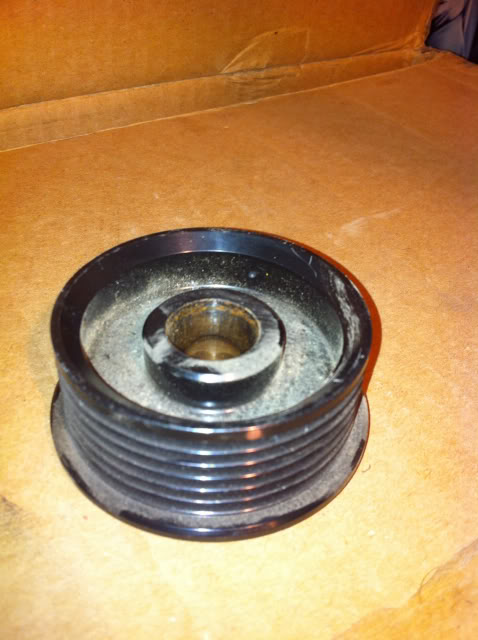

It's kinda hard to see, but in the second picture it looks like an aftermarket pulley. I can't remember the company that made that one.
I have the alta (below) still hard to see.
The stock pulley looks like this.
