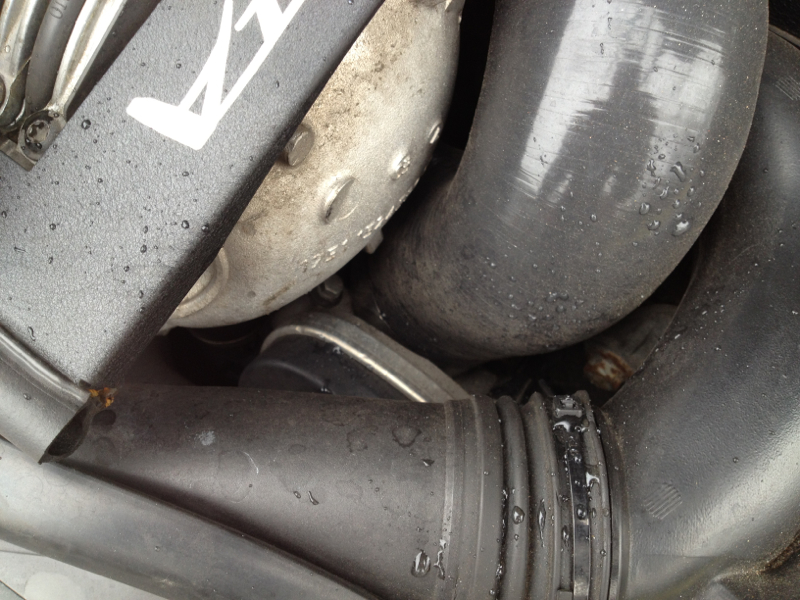

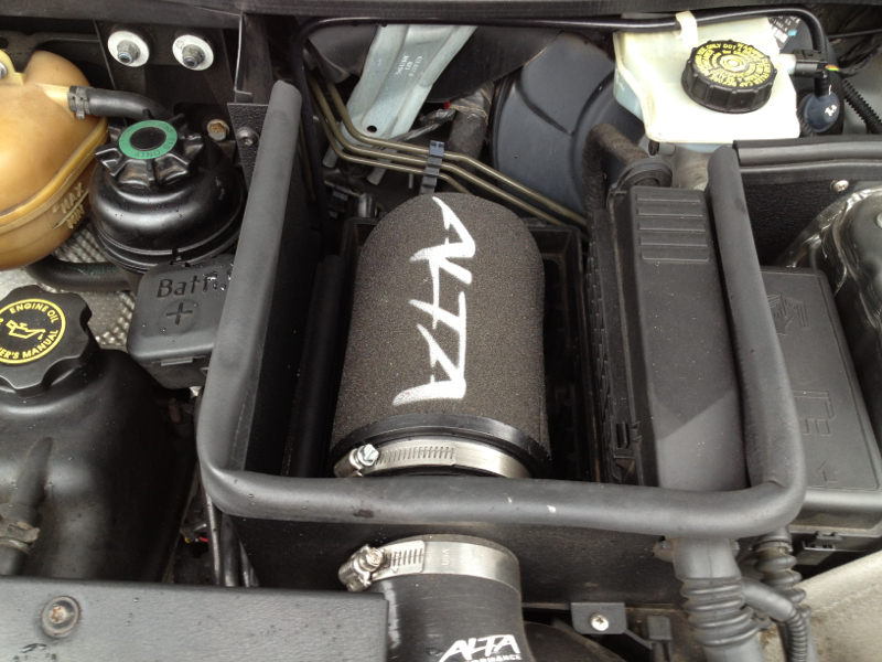

Not sure if I am correct but I think the header is , when looking at the motor from the front, on the left side. Alta's CAI sits on the top right. The tube they supply in the kit goes down to the intake manifold I believe. Also I cut out the separating piece under the cowl vent to fit the box. Everything seals up under the hood and the cowl vent acts as a vacuum for the intake. Great noise and even better with a pulley reduction. I have more pics if you need them.
