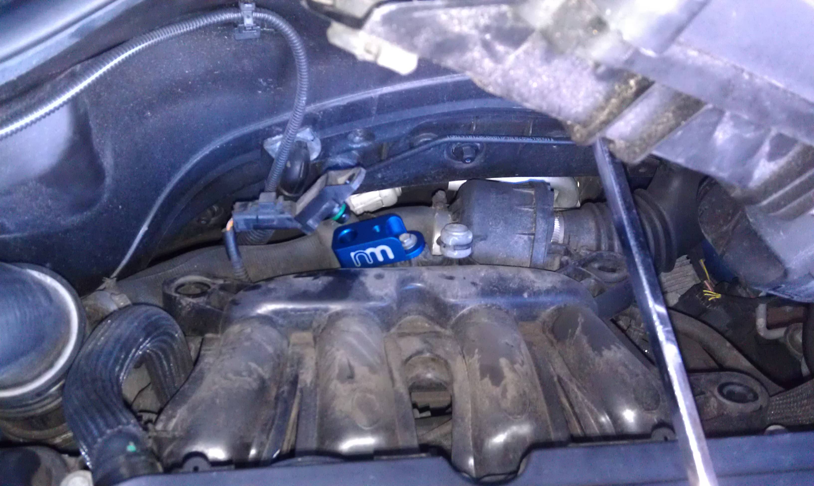

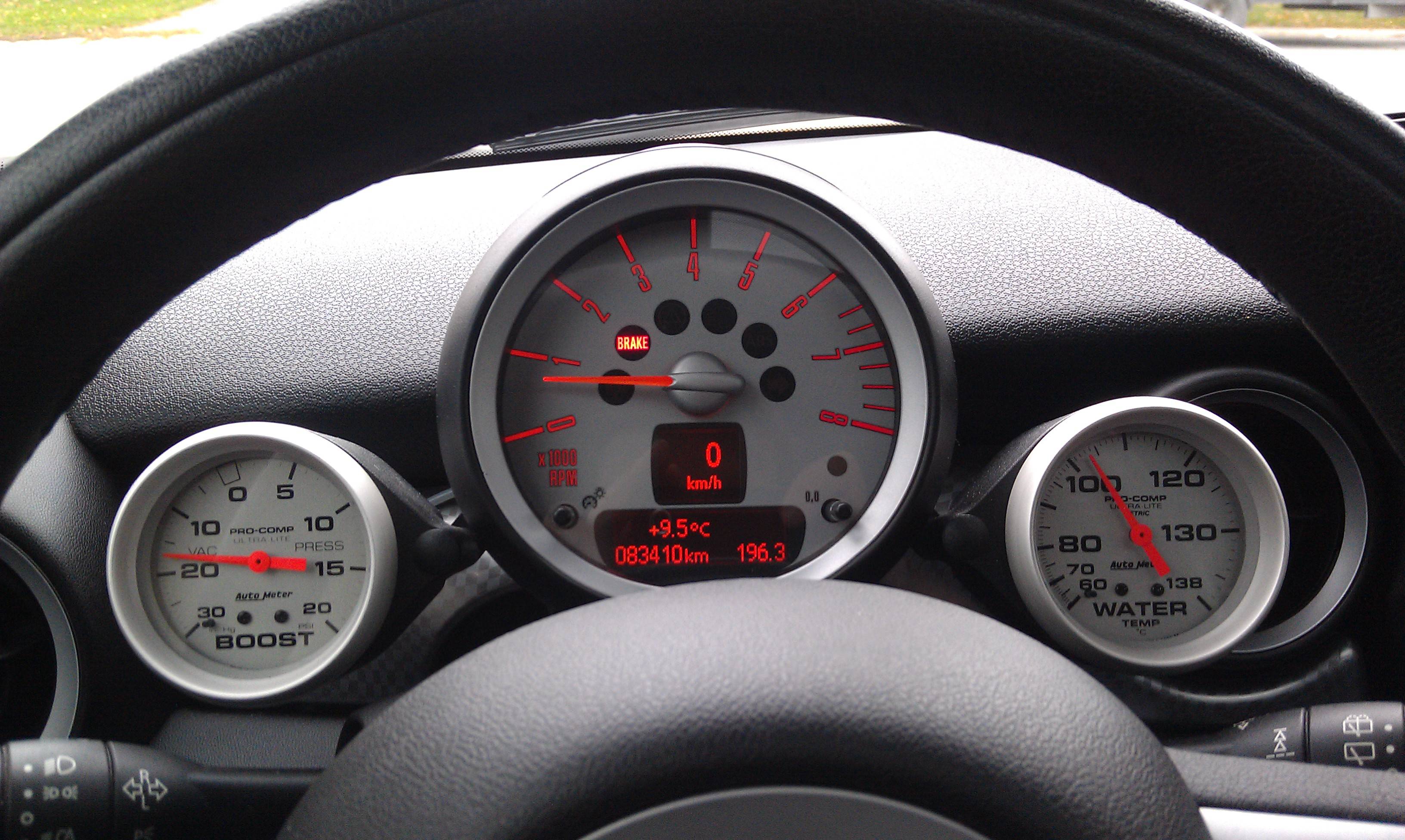

I installed a set of Autometer mechanical boost & water temp gauges. For the MINI, the best way to go (mechanically) is to tap into the MAF sensor and route the boost line through the electrical conduit within the firewall. I drilled a small hole in the plastic wall and put a grommet around it so the cut wouldn’t scratch the boost line. My Autometer kit came with the necessary boost tube and connections.
To mount the gauge I suggest the Cravenspeed kit. It’s expensive, but I tried to use the Autometer mounting kit I used was too big. This kit is designed for the Mini, so it fits better, but my gauge has to sit out a bit more than intended to allow the boost line to curve into the gauge still.
If I were to do it again, I’d go electrical gauges with this car so that you can maneuver the wiring through the tight spaces easier. It’s no fun worrying about bending a capillary tube or boost line too much and ruining it, and space is already at a premium.
Any more questions just ask, I might have missed some things. It took a good day to do since I’ve never done anything similar before.

^^ I believe you mean the MAP sensor not the MAF? Also the gauge pods alta sells work similar to the ones mentioned above, they use the tach to mount. Both are pretty much the same so either will work well

Can you give me a little more info on how to tap into the Sensor?

Assuming a mechanical boost gauge: http://www.cravenspeed.com/product_i...4-psiclone.pdf
Alta, NM, etc. all have similar adapters. You don't want to tap into the electrical circuit from the stock MAP sensor as you will confuse the ECU if you don't know what you are doing. If you must have an electrical boost gauge then you would still use the adapter to connect an air pressure -> electrical sender to create the signal to the boost gauge. But why complicate things? Just go mechanical.

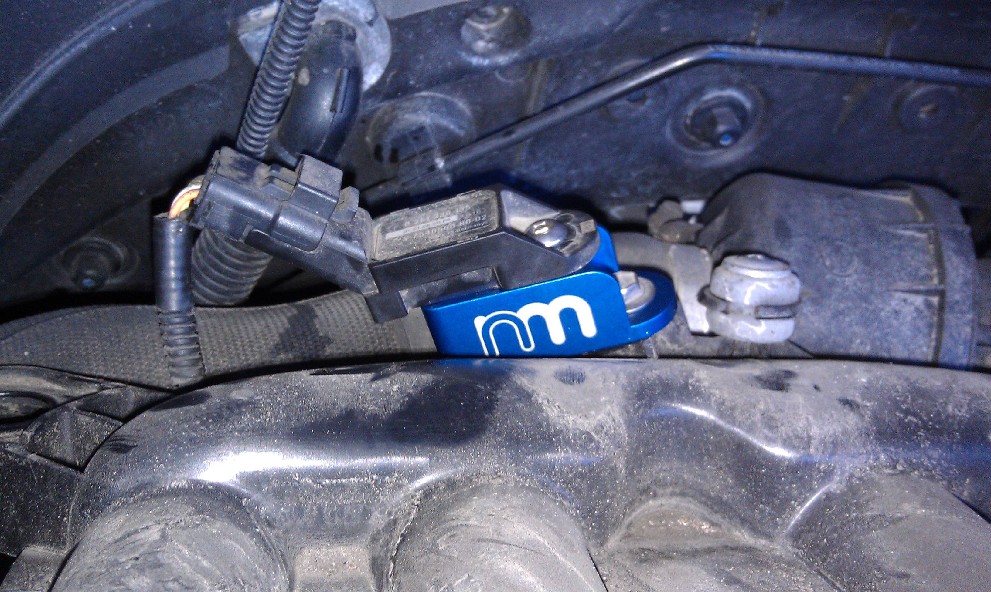

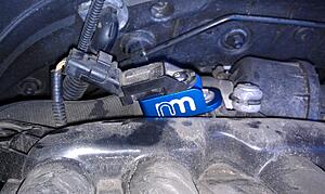

I sent you a PM but I'll also put it up here in case anyone else is searching later:
I used an adaptor (http://www.outmotoring.com/mini-coop...t_adapter.html). The link I gave you is the one I used, but there's a few out there. It sits underneath the air filter box. Below are a couple photos to give you an idea of how it sits. My Mini is in storage right now so unfortunately I can't grab another photo for you. The first one is without plugging the MAP sensor in, and the second is just before I put the filter box back. A bonus with this type of setup is that I'm not getting any CELs.
The part that you attach your boost line into can't be seen in those photos (it wasn't installed at that point). The back of the blue adaptor has a female 1/8" threaded hole for a boost line. My gauge kit also had brass female connection, so I had to go to the hardware store to find the appropriate male-male brass connection. I think I put a little 3 in 1 oil on the gaskets and I also used liquid Teflon on all the threads to stop any potential leaks.
For the gauge itself, my kit had instructions:
http://www.egauges.com/pdf/AutoMeter/100v.pdf (look at the mechanical boost section)
The difference between my setup and the autometer one is that instead of a 'T-Fitting' I used the male-male connector.
Hopefully that helps, if there's anything else I can do to help, let me know!
