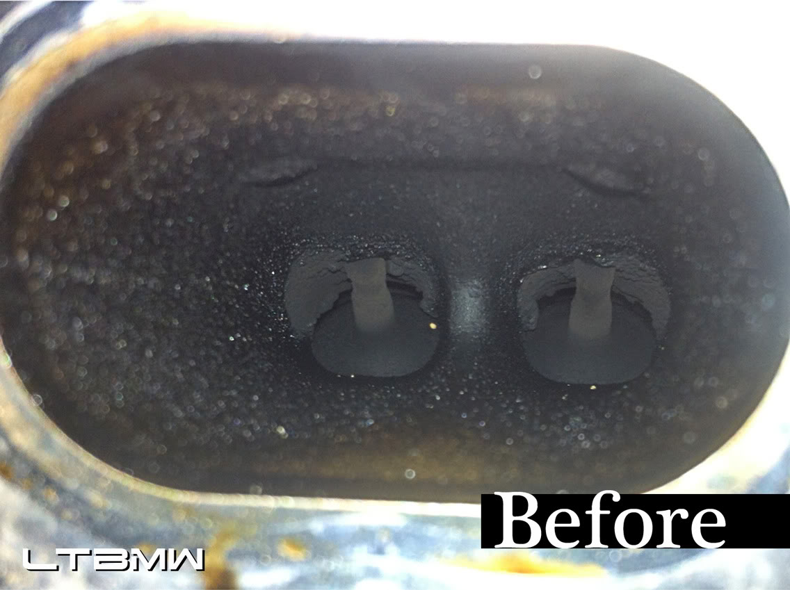

Originally Posted by RobMuntean
I have 42K miles on my MINI. I recently took it to the dealer and asked them to check for carbon on the valves and they reported back saying it was really nothing there just some that has attached onto the valve. I said, "okay". I am going to install the BSH OCC next weekend but before I do it I'm gonna take a look for myself to see if it is as bad as I have seen some N14 engines. I've only seen one N18 engine where it looked bad but not worse then those N14 engines.
That's such a bad/vague statement from your dealer/tech.
This was how my valves looked @ 39k miles w/ no tracking. I'm @ 47k miles and I've done several track days now, but I've also had a meth kit so I'm sure my valves aren't bad still. You really should consider getting the work done to clean out the valves.

Yeah your telling me, I was shocked how they said it, I couldn't even muster a word. I'm definitely thinking about doing the job myself within these next two weeks and installing a OCC right after. I'm gonna buy the catch can Saturday.
