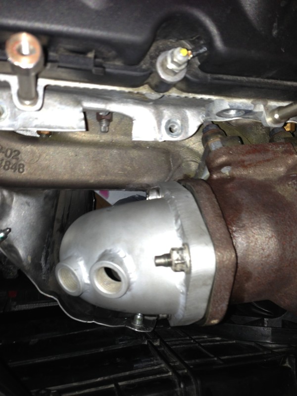

Hit a snag with the studs connecting dp to turbo. Need to go pick up some new ones today. Also I had to trim the lower dp heat shield to get the lower o2 back in. Maybe due to mine being a JCW, but the linked directions where a bit off. I had to remove lower heat shield to get the factory dp to come out.
You almost certainly have to remove the lower heat shield to get it out....the factory cat is pretty fat lol.
I had also ran into the stud issues when I was doing the install awhile back....stupid bolt was stuck to the stud...and there was no way of getting it off without destroying the threads of the stud.

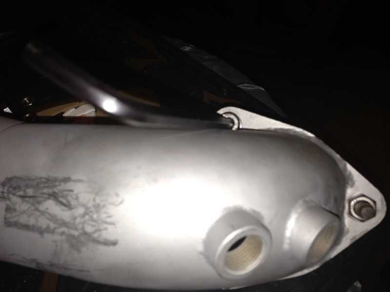

No wrap, but I did get the ceramic coating on mine...speaking of it is finally installed on the JCW Coupe. It was a bit of a bugger due to clearance issues on the lower studs (actually swapped those out for socket head bolts). A combination of the 3" pipe and the JCW header made for a difficult situation. I would be curious to hear feedback from others who have installed the AR Design downpipe on their MCS or JCW.
Attached a few pic showing my situation.
Attached Thumbnails GTB Performance Official First Look : AR Design Downpipe!-dp1.jpg   GTB Performance Official First Look : AR Design Downpipe!-socketallen.jpg   GTB Performance Official First Look : AR Design Downpipe!-dpinstalled.jpg

When I installed my Akrapovic, and my Riss Racing DP, all I had to do was install the bottom ones first and keep the DP off the turbo as I tightened it, no issue.
