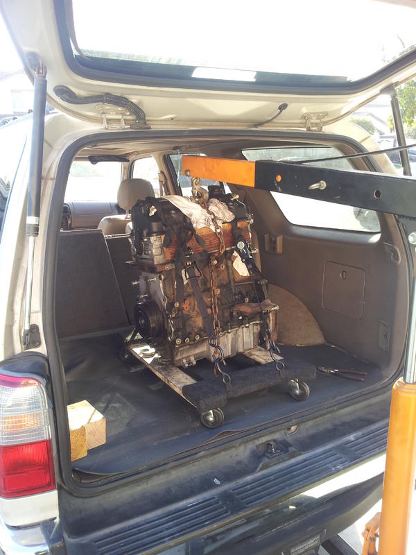

From: California
random pics

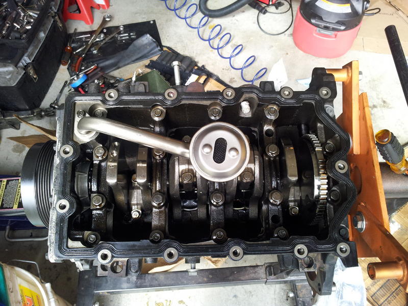

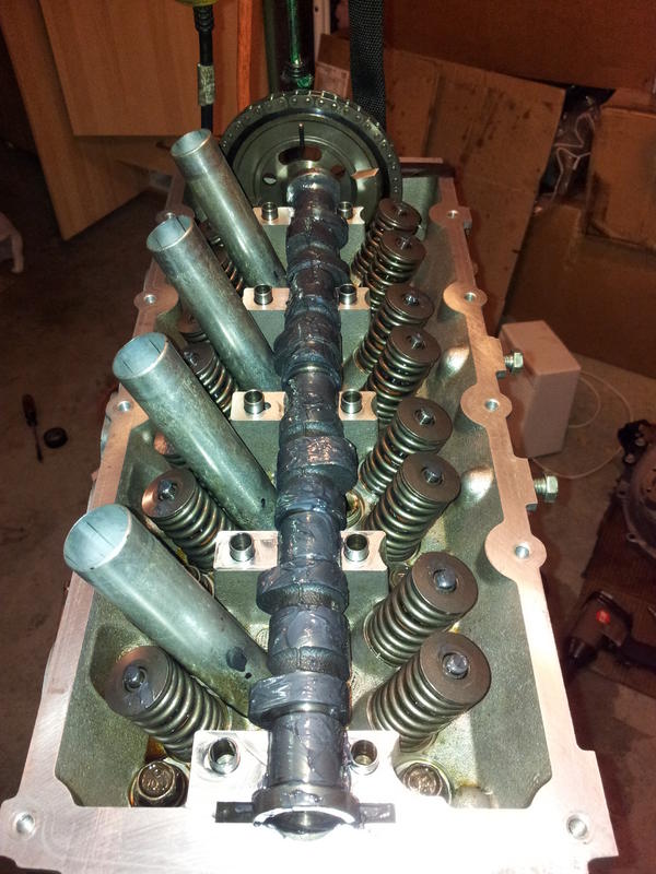

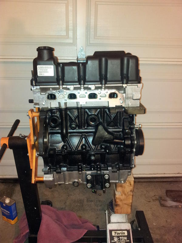

coming home after a long period of being stored
bottom end inspection
top end inspection
Attached Thumbnails Should i transplant a jcw into my mcs?-20120225_160216.jpg   Should i transplant a jcw into my mcs?-20120226_135254.jpg   Should i transplant a jcw into my mcs?-20120226_145817.jpg

degreasing
painted block
schrick getting transplanted
Attached Thumbnails Should i transplant a jcw into my mcs?-20120226_154946.jpg   Should i transplant a jcw into my mcs?-20120227_173017.jpg   Should i transplant a jcw into my mcs?-20120226_145802.jpg

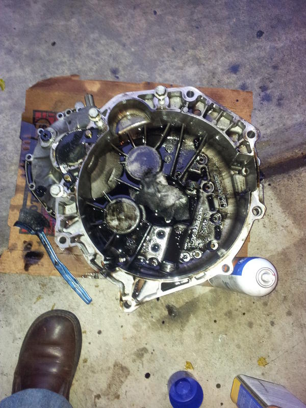

random pics
degreasing the tranny
shitty day in sunny san diego
ah the clean tranny
Attached Thumbnails Should i transplant a jcw into my mcs?-20120227_174303.jpg   Should i transplant a jcw into my mcs?-20120227_174327.jpg   Should i transplant a jcw into my mcs?-20120227_181612.jpg

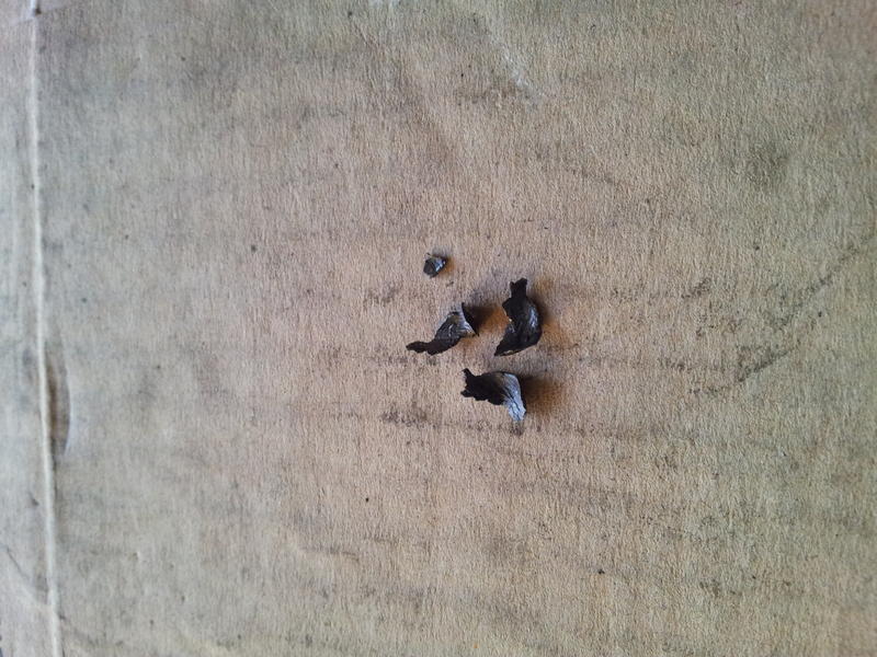

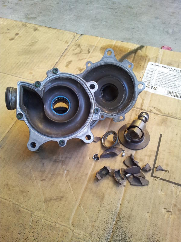

parts
massive A2W radiator
gutted the oem water pump (going electric pump) for re-use. i tried to be nice to it but it was stubborn and lost the battle to the hydraulic press.
oh yeah just a few loose metal chunks from the obx
Attached Thumbnails Should i transplant a jcw into my mcs?-20120220_151447.jpg   Should i transplant a jcw into my mcs?-20120307_154039.jpg   Should i transplant a jcw into my mcs?-20120308_153335.jpg

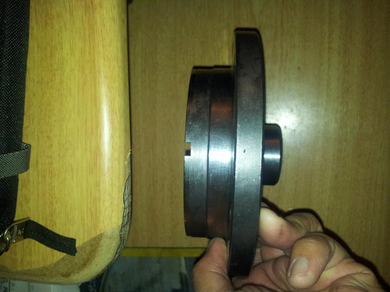

Update on the obx lsd modification
Before i did this gutsy move on my LSD i did some reading on honda forums about thier experience on OBX LSD. Some are tracking thousands of miles without issues and there are those people that had problems with it. I know the consequence of voiding the warranty from my seller if something would happen directly or indirectly of this modification. oh well.....
to sum up the things i did before the modification i did the following.
- cleaned up the sharp edges with my dremel tool.
- i had it plastic beaded ( a guy here i believe did a glass bead and turned out beautiful)
- ordered the stronger washers and bolts.
Old Mar 16, 2012 | 07:22 PM

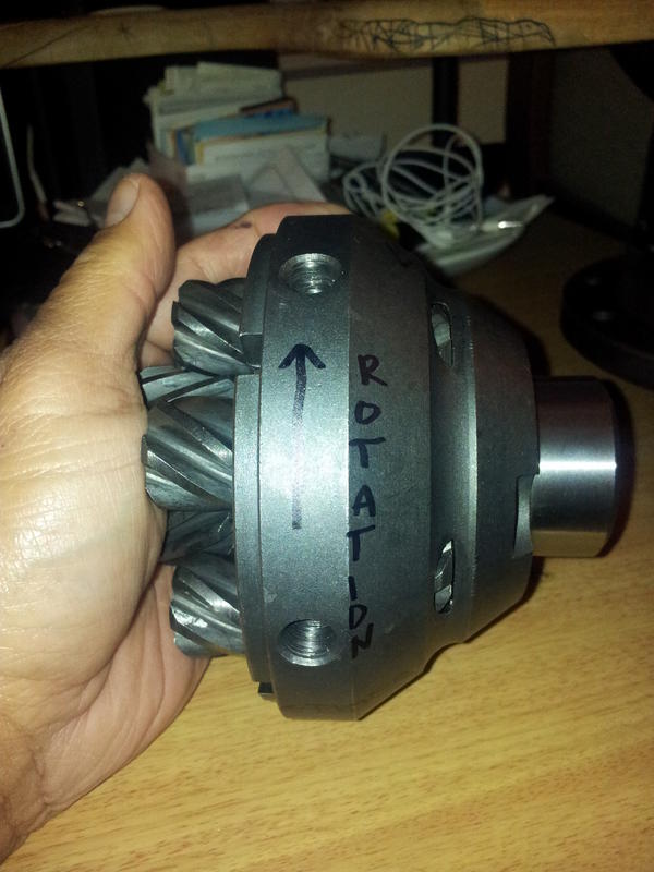

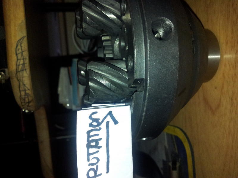

OBX oil flow
- 1st pic, this is how the obx going to be installed in the tranny and that arrow is the point of rotation when the vehicle is going fwd.
- 2nd pic, the oil will enter in that hole (see the coil? we'll call that coil as lower coil because when the housing is standing up its at the bottom) and because of how the helical coil spins inside the housing the oil it will exit to the right (marked exit). With that said the lower helical gets all the positive flow of oil coming in. the upper coil may only get partial oil and or low flow of oil because as oil enters it exits right away.
- 3rd pic, here is the modification done to the LSD, added oil passage way. As the LSD housing spins it scoops the oil in and showers the upper coil. Because of how the upper coils spins inside it brings the oil up to the driver side drive gear.
Attached Thumbnails Should i transplant a jcw into my mcs?-20120316_182309.jpg   Should i transplant a jcw into my mcs?-20120316_182354.jpg   Should i transplant a jcw into my mcs?-20120316_182535.jpg

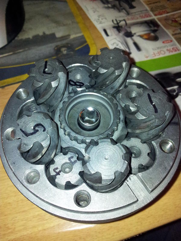

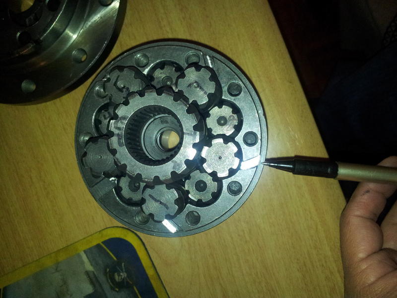

OBX mod
- 1st pic, oil enters
- 2nd pic, helical coil rotation, as oil enters the coil will bring it in to the left lubricating the driver side axle gear
- 3rd pic, oil exit point
Attached Thumbnails Should i transplant a jcw into my mcs?-20120316_182456.jpg   Should i transplant a jcw into my mcs?-20120316_182929.jpg   Should i transplant a jcw into my mcs?-20120316_183122.jpg

OBX mod
- 1st pic, other half of the housing. noticed the cut? that's the entrance point.
- 2nd pic, here is how it will look.
- 3rd pic, just to show the upper and lower helical coils (before the mod pic).
Attached Thumbnails Should i transplant a jcw into my mcs?-20120316_182620.jpg   Should i transplant a jcw into my mcs?-20120316_182755.jpg   Should i transplant a jcw into my mcs?-lsd2.jpg

Theory
Why did i do this? because i can .
Like i said the honda guys racked up some thousand miles w/out the issues. Some did the clean up and changed the factory washers, i'm doing that too.
On the net i saw some chewed up driver side axle gear and cooked up oil spots. My theory is that the upper helical coils don't get much positive flow of oil compared to the lower ones which drove me to do this. The issue could just be material finish from the factory but at least i know the upper coil and driver side axle gear will get MORE flowing oil thru them.
Ok guys shoot my post with bullet holes, make comments and criticism but be nice.

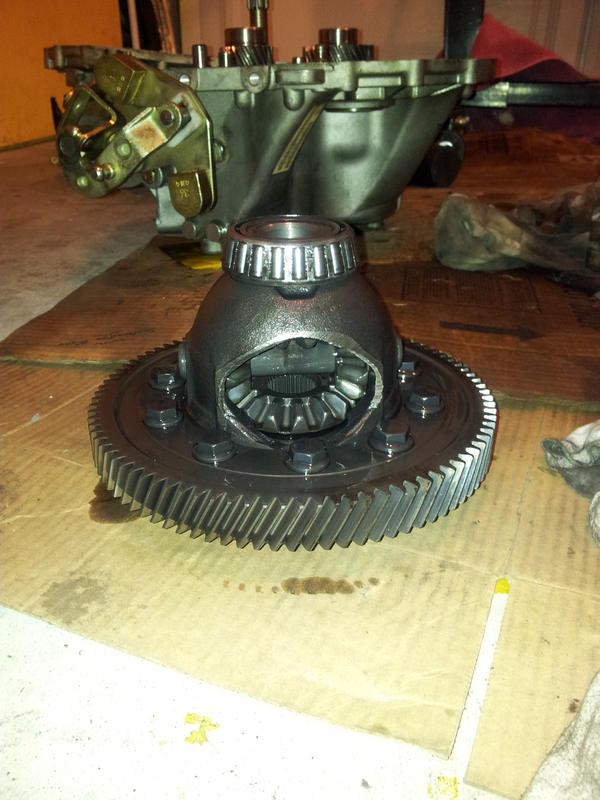

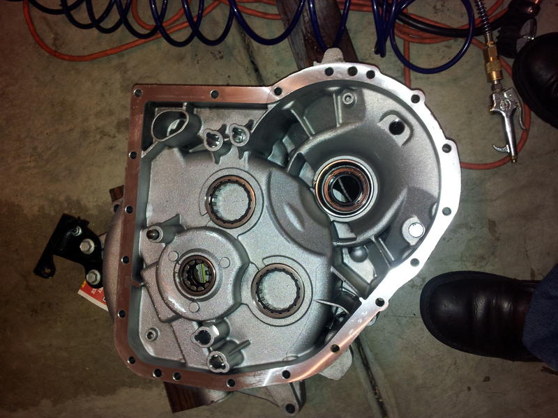

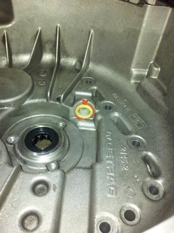

Prepping 05 tranny
1st pic, re-installed useable bushing and used hi-temp silicone to isolate little movement. Make sure clean silicone around it, no more movement with silicone.
2nd pic, cleaned, measured some tranny parts and run bolts thru tap and die to clean threads. Note the 3 piece bearing
3rd pic, this was yesterday during assembly of the LSD.
Attached Thumbnails Should i transplant a jcw into my mcs?-20120322_212129.jpg   Should i transplant a jcw into my mcs?-20120322_210902.jpg   Should i transplant a jcw into my mcs?-20120321_135048.jpg
