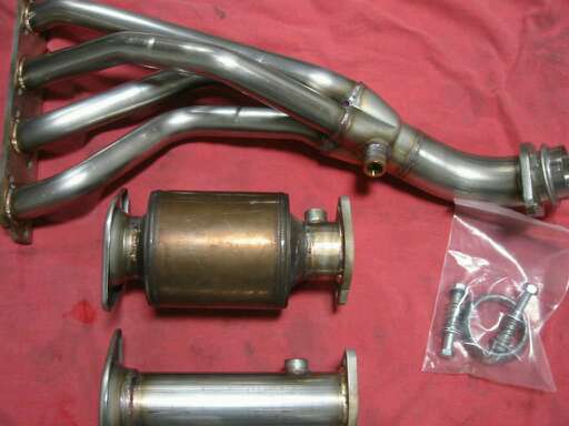

I installed a Mynes V2, one of the things they do is use the OEM cat. I have had not one code since install and performance does not seem to be affected at all using the OEM cat.
Attachment 57048
JCWSLAYER, I can see why, the primary O2 bung on the Mynes header is actually extended to not throw a code, same a using a 02 defouler and the stock cat is being used still.
It works is the point, not one code or problem in over 8 months.
