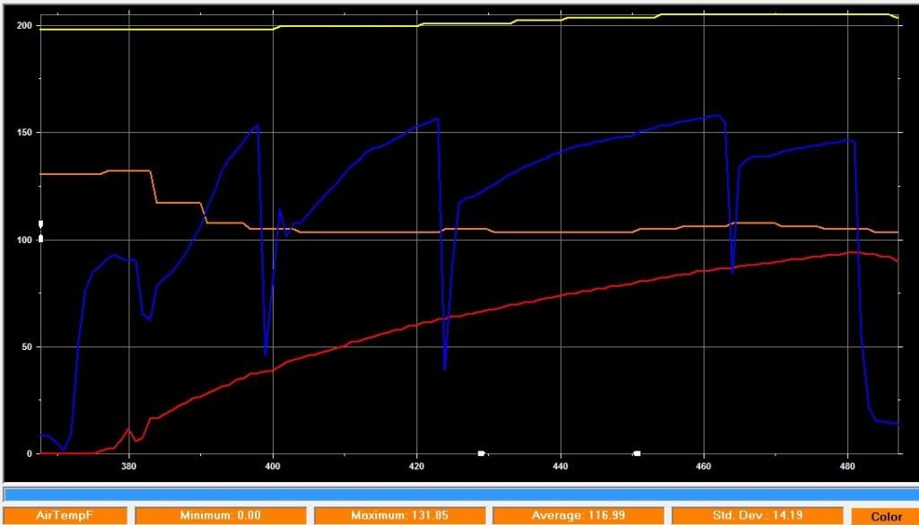

) and have a DFIC with the exit scoop. It was also pushing 90* ambient temp at the track right before a rain storm.
The Yellow line on the log is coolent temp (top of graph) Orange line is the actual recorded intake temp (taken off MAP sensor 2) Blue is air mass (easy to aee gears and RPM) and the red line is speed in MPH.
) and have a DFIC with the exit scoop. It was also pushing 90* ambient temp at the track right before a rain storm.The Yellow line on the log is coolent temp (top of graph) Orange line is the actual recorded intake temp (taken off MAP sensor 2) Blue is air mass (easy to aee gears and RPM) and the red line is speed in MPH.
PAImport, I agree w/ you, if your water volume is sufficient and your radiator is sufficient, heatsoak will not be an issue, think about how much heat an auto engine puts out but yet when the tstat opens and the elec colling fan turns on, the temp drops within seconds. And if you really want to go hardcore, an ice chest can give you absurdely low IATs, that no A2A could ever in this universe come close to matching. Just a pure matter of physics.
