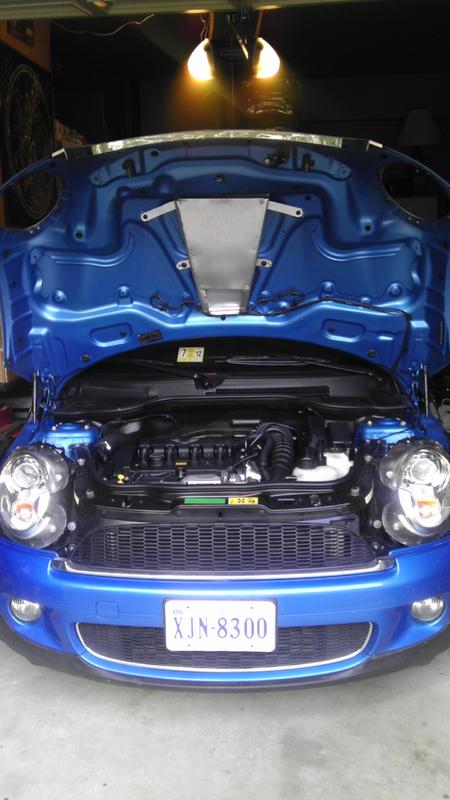

I wanted to use my scoop for something other than looks... so I got 2 sheets of 26 gauge sheet metal and I fashioned a "ram air" scoop attachment like a lot of different companies sell. I just couldn't see spending over $200 for their versions of essentially the same thing! I did this in about 2 hours with hand snippers and a ruler, so it is not perfectly straight. Seeing as my hood spends most of its time closed, I don't really care. I will pop it off and spray paint it black within the next couple weeks. Anyways, just thought I'd share!

I like your idea of fabricating it yourself but if you’re going to fabricate something, why not make this?
At least this part would have some function (keeping the turbo cooler)
Unfortunately, your car is fuel injected and you can’t ram air into a closed system... it simply doesn’t work on a fuel injected car.

I like it!
It will help keep your intake temps down, but that's about it. You could probably cut a hole in the front of it and attach something like Mark posted too.

that would be WAY easier to make than what I did! so does this divert the air down from the scoop over the turbo?
and yea I know about the whole FI ram air thing, hence the quotes in my title... because really the turbo controls the air intake anyway... I just wanted fresh air getting to my filter.

so does this divert the air down from the scoop over the turbo? .
Yes, it cools the turbo (which is very much needed)

With the OEM intake, I admit this thing have not much utility, but with some CAI (like the alta) that take air right there, this instalation can be useful...
Now, wich one is better ? Air ram with CAI or turbo cooling........

I see a big problem. The dirty air comes through the snorkel on the bottom of the filter. The top side is supposed to be clean air. The ram looks like it is cut into the clean side of the filter housing so now dirt just goes straight through into the engine. If it has a cone filter inside the box then I am wrong. But if it is a panel filter like my JCW then we have a problem
Cone filter. Wanted to hear the BOV but didn't want to be sucking in all that hot air. There isn't a heat shield in this picture so at this point it wasn't very good, but a 90degree pipe and an insulated shield solved the heatsoak problem. I don't have this specific MINI anymore, though.

sucking hot air causes a loss of power, but that is why I fashioned that box to draw the fresh cool air from the scoop.
it was a rough draft and obviously needed more work, but the point was just a proof of concept. an aerogel heat shield over the turbo plus the above mentioned mods made this a pretty viable homemade solution.
