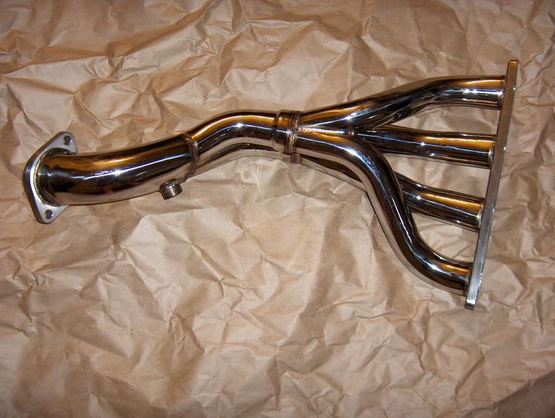

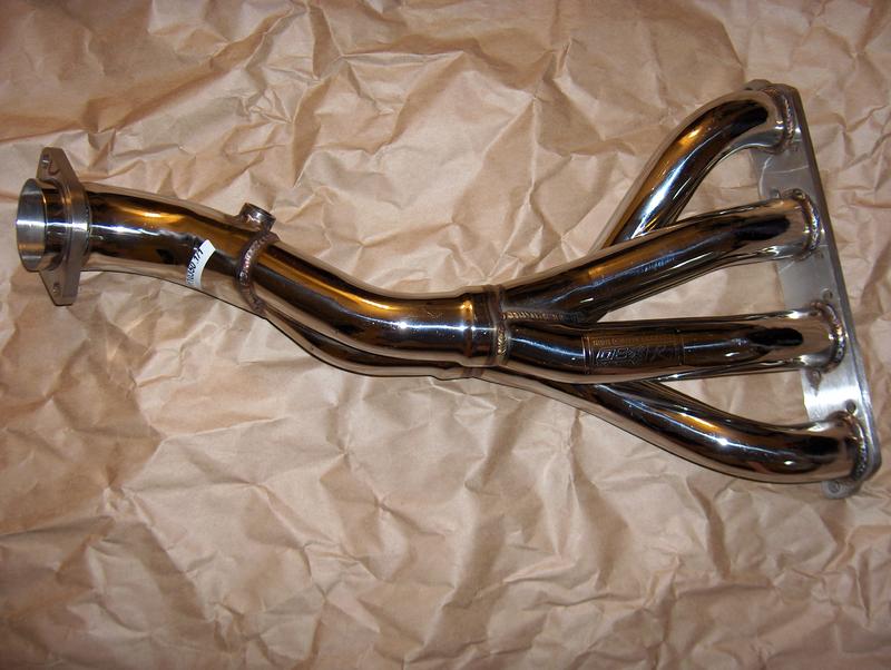

Got my new Header. It looks pretty nice to me!!!
Attached Thumbnails Please, Need help With Header!!-header-004.jpg   Please, Need help With Header!!-header-005.jpg
Old Aug 20, 2011 | 06:54 AM
NAPMINI's Avatar
NAPMINI
Joined: Mar 2010
Posts: 14
looking good... can you take a pic of the ports?
Old Aug 20, 2011 | 12:30 PM
hattenzoom's Avatar
hattenzoom
Joined: Jul 2010
Posts: 34
Very sorry. I receved it at 6:something pm on the 18th and had it installed at 9:00am on the 19th. I can tell you that the flange was/is thick, flat and straight . The ports were/are oval, not "D" shaped, and matched the new gasket perfectly, and I do mean perfectly! Looking back I should have taken more pics. It's so pretty it's a shame that it's hidden in the engine compartment.

Me too! I was worried about that when I orderd. I also posted 3 more pics on a different thread. "Just installed OBX header easy peasy lemon squeezy "
Here's the flange view!
I took that pic because at first I got the newer steel painted version It was pretty horrible in quality, ports all messed up and probably more restrictive than the oem manifold Then I got my hand on the older Stainless Steel version which is a damn nice piece in my opinion!
