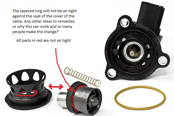

For reference, i still want to make the change but am at a stand still because of the non air tight design. Has anyone else verified my findings?
Size:  46.0 KB[/quote]

C'mon guys think about it logically, there is no way it can provide an air tight seal, and no amount of heat will do this, or it will have an interference resistance on the piston plunger, and slow even maybe stop it's action!
The reason quite a few, lets discuss BMW Mini here not VAG'S, are saying it's an improvement is quite simply, they will be feeling the smooth action of the valve piston VS the resistance of the rubber diaphragm, it's also quieter due to it's air control design.
When you install this valve on a stock engine with stock boost levels, there is a definite slowing of the spool time of the turbo (i've tested and measured this) however as it is so slight many owners may not notice this, as they will be feeling the smooth action of the valve piston.
Now when installed on an engine with increased boost pressure, (tune etc etc) the effects of the smooth operation are enhanced, and although people are impressed, it's only the difference between a resistance rubber diaphragm VS a free moving piston!
Now matter how you look at it, it will never ever seal as good as the stock factory rubber diaphragm recirculation valve, and when you fit a revised rated spring to your stock rubber diaphragm recirculation valve, this will give you a faster spool time, than the VAG valve!

Ok so I pulled my DV back out and inspected the VAG internals again. Something I did not catch before was that the piston is tapered. So when it is forced shut the conical ring does allow for a good seal. I even blew air threw the piston to check.
However since it does get pushed in some what when it is installed the ring sits higher on this tapper and probably does not seal. Again I tested this too with it pushed in similar to it being installed. It blows air past the seal.
My guess is that the VW and Audi housing this VAG DV is intended for are slightly deeper. It would probably seal with a spacer added to give the MINI turbo housing depth, but we still don't have definitive proof the piston will seal against the housing then too.
Lame now I get to listen to the stock one again. Thanks for bursting my bubble.
