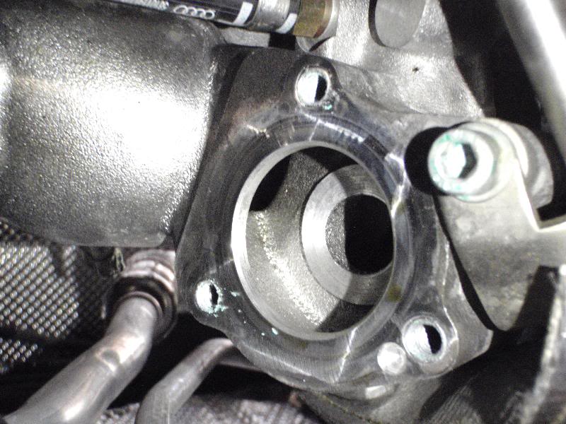

Ok guys...
Bad news....
CZAR is right to a certain extent.
I am not gonna post pics because there is an easier way of verifying my findings. Mind you i have been studying this design for the past week.
The VAG will NOT hold a tight seal. the rubber diaphram(on the inside of the valve , the yellow piece) is integral to making a tight seal. the plunger is not the important part. No matter how tight the plunger on the vag is, if you blow on it just lung air pressure will escape as it is not INTERNALLY air tight. Air will escape between the plunger and the tapered seal of the plunger against the dv cap that holds everything together.
My recomendation is take it off! touche to CZAR for starting this investigation.
Im taking mine back tomorrow.
Like i said... pull it out and blow on the plunger itself and you will see that it leaks air.
Sorry guys. If you have questions ask.
The design of this valve im sure is for added drivability so the slight leak makes things smoother as the air is not bursting out.

So the VW and Audi guys are assed out too then? They do in fact have the same housing as expected. Very odd
