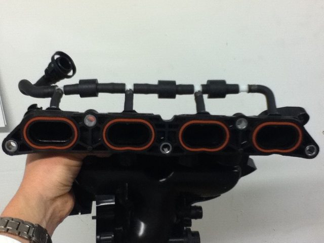

I went to My local MINI dealer and talked to the shop foreman. The 2011 MINIs have a different head and valve cover, with 4 passages from the space under the valve cover to the intake ports, one for each port. This is what replaces the hose from the passenger side of the valve cover to the intake manifold. He said that there was a problem with oil pooling at the throttle on the earlier engines.
I'm wondering if BSH has a way of blocking off those ports on their new design.
Dave
Old Mar 8, 2011 | 11:39 PM
  #61
fishbert's Avatar
fishbert
Joined: Jul 2008
Posts: 1,174
Likes: 13
From: Ohio
Dave
Very interesting.
Sounds similar to what they did with the recently updated intake manifold for pre-2011 engines.
If it's still directing fumes to the intake ports, though, carbon buildup may still be an issue. And it doesn't sound like a catch can is do-able any more to help prevent that.
