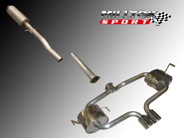

I have looked at the Milltek website and it shows a pic of a system (attached), can anyone tell me if this is for a 2004-2006 R53 or for a 2002-2003? See Pic.
Also, in the description for the system on the Milltek Website, it indicates that the system includes "locators for 2004 cars". Does anyone know if the 2004-2006 systems are built as a direct bolt these years, and these locators allow a retro-fit for the 2002-2003 models or is it the other way around? For any 2004-2006 Milltek users, was your system a direct bolt on?

On the rear mufflers the inner hangers can be changed.
When they point toward the middle they are for the 04-06, if they point like the outer hangers front to back they for the 02-03
Looking at your pic you already have the 04-06 hangers installed
