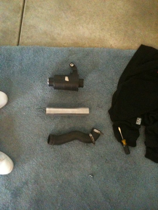

So today I had a little time and decided to do remove the intercooler muffler. It took me about an hour, the tubes are a real pain, but all in all it's a pretty straightforward install.
As far as parts, I bought a 2 inch diameter aluminized steel pipe from my local auto parts. Cost = $7.99
(If you are worried about rust, pick up a bottle of high temp paint and give the pipe a few coats inside and out)
For the install I moved the coolant overflow out of the way so that I could access the mounting bracket for the intercooler muffler. I loosened all the hose clamps and then removed it.
I matched the length of the new pipe to the intercooler muffler, tightened everything up, and reinstalled everything. Make sure you double check all hose clamps because you don't want on of the tubes coming loose when you step on the gas.
As far as performance increase, I think it's probably negligible, but you can definitely hear the turbo alot more. This sure as hell beats spending a hundred+ bucks for an aftermarket silicone hose or muffler delete pipe.

any tips on removing the bolt holding the muffler in place? I spent a few hours trying to get at it from the bottom/top and couldn't remove it. Was trying to use a t25 socket on a 1/4 ratchet.
Old Oct 31, 2010 | 12:56 PM
com3tojo3's Avatar
com3tojo3
Joined: Jan 2008
Posts: 220
From: SoCal, Germany, Iraq
It's the hardest part of the whole install, I got it from the top. It might help to push the coolant hose that is in front of it to the side

Posts: 184
What tool(s) did you use?
Old Oct 31, 2010 | 01:13 PM
com3tojo3's Avatar
com3tojo3
Joined: Jan 2008
Posts: 220
I used a stubby 1/4 inch drive ratchet with a torx bit

It would be a good idea to use a pipe flange tool to slightly expand the ends of the pipes to ensure a better seal.
Old Oct 31, 2010 | 02:23 PM
com3tojo3's Avatar
com3tojo3
Joined: Jan 2008
Posts: 220
Ya, any local muffler shop can do it for you in about 10 seconds. I've put 300 miles on the car this weekend without issues, you just have to make sure all the hose clamps are tightened correctly.

Details on the intercooler? Ebay core with your own end tanks?
Also, would it be a bad idea to use PVC instead of aluminized steel?
The only thing would be @ 2" Diameter, the wall thickness of the PVC would probably on the thinner side.

Considering it is on the hot side of the intercooler, I don't know how well pvc would hold up. If you want to be the guinea pig you could try it and let us know

anybody know how much piping i should buy? 1 foot seem ok or best to go with 2 and trim down.
Lastly, is it right to assume that everybody has been successful in installing this tube without removing the front bumper?

You will only need 8 inches of pipe, and no, you do not have to remove the front bumper, you only need to move the coolant reservoir out of the way

I'd check for leaks if I were you. You can bead the pipe ends with JB weld or Epoxy. Just put 2 peices of tape with about 3/16" gap between and put a bead around at each end. Remove the tape before it sets too much. If you have any lumps just file them smooth once it dries.
