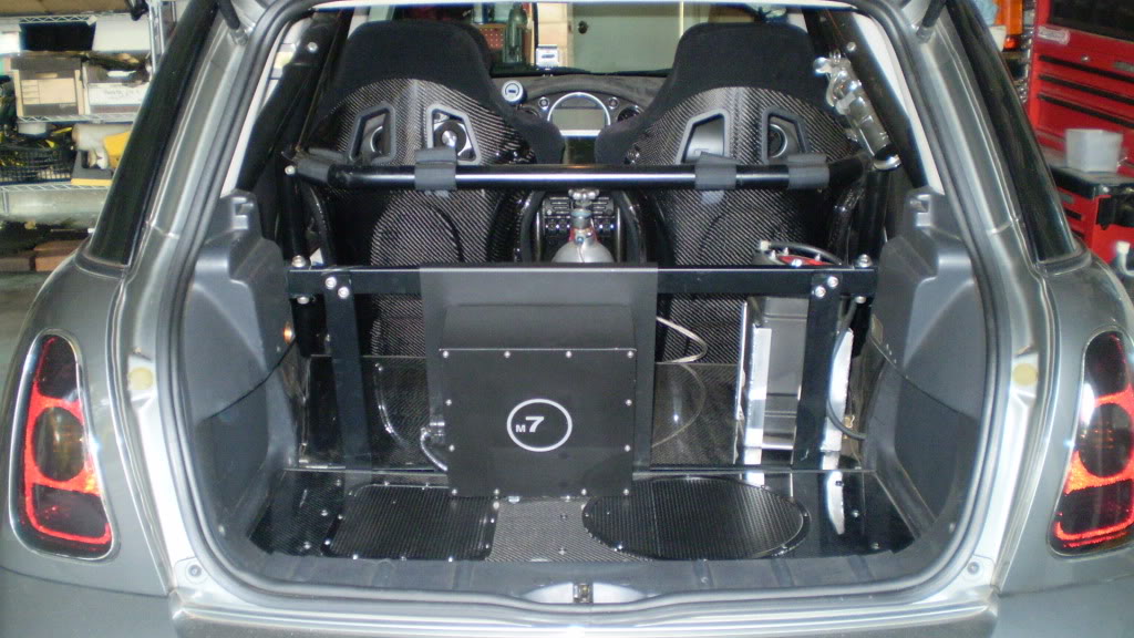

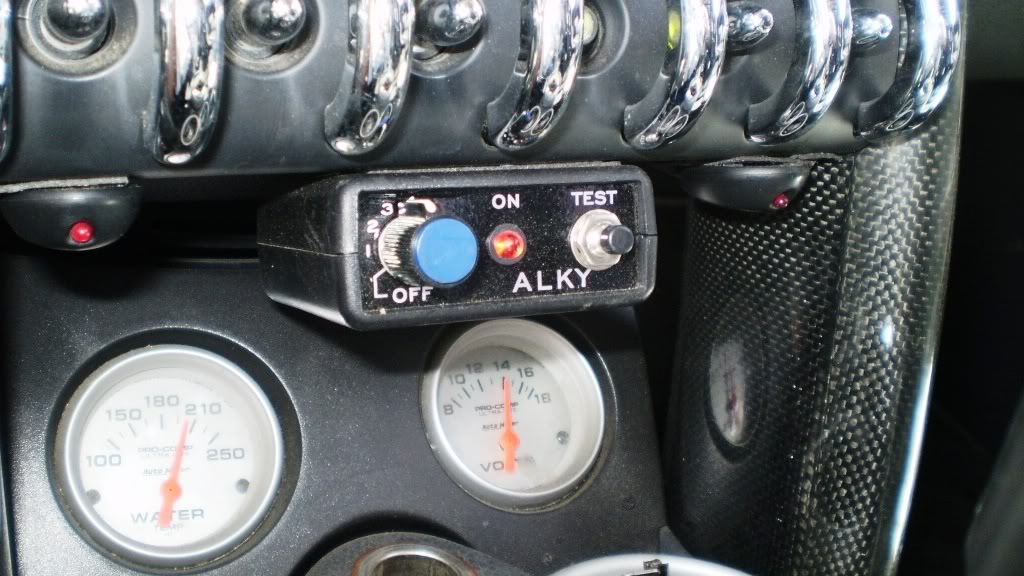

I added a Alky Control system to my car after the last tune so this is strictly untuned results.
After stop and go traffic and sitting a bit my intake temp was 134.
Armed the system , accelerated hard up onto the fwy and four gears later intake temp 66 degrees .
Ambient temp 92 degrees.
This was the main reason I added this to my car as a way of being " nice " to it during those hot So Cal cyn cruises .

^ nice meth kit Randy

Thanks but you are the one that actually maximized its potential.I just put it on with the company recommendations and rode off into the sunset LOL . Good quality stuff from tank to nozzle though. Not a plastic tube or tank in

That is a sweet setup Randy.

Randy, what is that carbon fiber intake piece? Is M7 getting out of the R53 business?
For the AGS

Clint, there is quite a bit of carbonfiber stuff on Randy's car. I have seen quite a few pictures of it, and it's one bad little MINI. If you are refering to the pice that D-man and me are thinking it is the heat shield on the old M7 AGS system, some where fiberglass but they made quite a few in C/F aswell. The AGS has been discontinued for quite some time, every now and then though one will pop up used. It was IMO one of the better intake systems, just because it got rid of the stock crappy plastic S/C inlet tube that is really odd shaped and has internal diameters that are all over the place. The AGS made the S/C super loud, only down side was the location of the filter tended to suck in a lot of heat which is why the heat shield was created. IMO if they where to bend the aluminum tube at the throttle body so you could use it with either the stock or any aftermarket intake it would be better, and I know they would sell atleast one.
