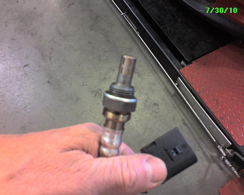

Here is pic of new/correct O2 sensor. Note the slots in the sides of it.

This is the Bosch unit.
If you had the Bosch Premium O2 sensor for like 60 bucks....that is totally different looking and not to spec's.

Testing my solder in sensor vs a good OEM resulted in the same voltage return. Its not a friggin wide band.
I actualy bought one listed as a Denso and it had the same tip design as my OEM Bosch... not sure how that worked out. But my code is gone on its own, I never did a reset.
