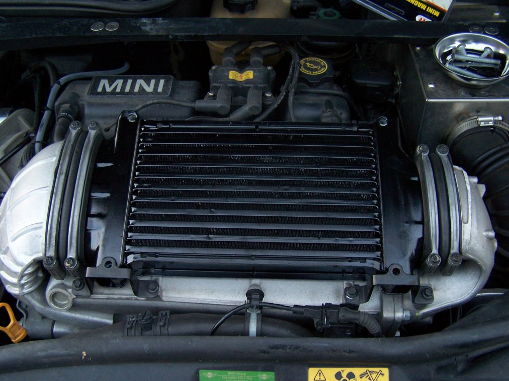

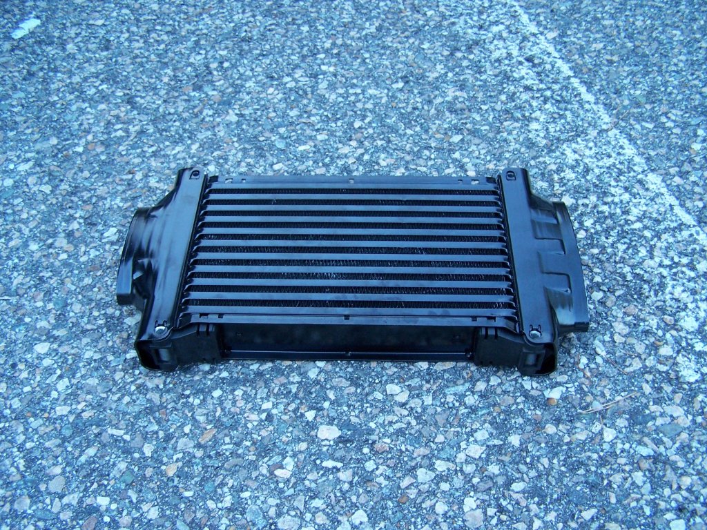

Here are some pics of the factory IC with the thermal coating. After taking a test drive to make sure there were no vacuum/boost leaks, I came back and parked. I could actually hold my hand on the IC for about a second before it felt too hot. That tells me the coating is working.

From: Utica, New York
^ looks good. how long did the whole thing take (sending it to them and getting it back) and that's not a bad price, 1. helps in performance 2. looks great!

From: Woodside, CA
Turn around is pretty fast...
on the order of a week, plus or minus.

Yes, about a week. I'm glad I finally got around to doing this.

From: Woodside, CA
It's cheap... It works (a bit)
and it's black!
So there you go!
Matt
And they do a really good job of cleaning the IC as part of the process!

I tested it...
dropped IATs a couple of degrees. No a lot, but it's a real effect.
